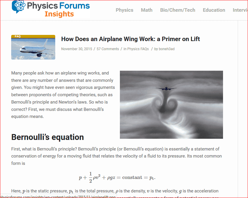

Check out this Insights article to see if it helps...
https://www.physicsforums.com/insights/airplane-wing-work-primer-lift/
