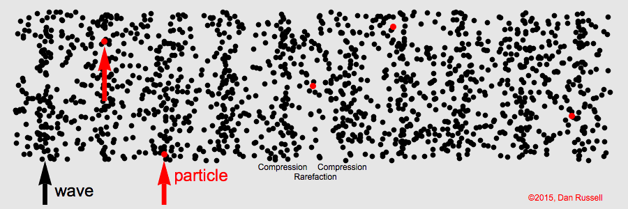

I'm coming back to physics after a long so apologies if this has a basic answer- How can the amplitude of a longitudinal sound wave be increased without increasing its wavelength? I understand what it would look like graphically if a low amplitude sine wave and high amplitude sine wave were representing this scenario (ie the two waves would have the same wavelength but their peaks and troughs would be displaced by different amounts from the equilibrium position showing the differences in amplitude like in graph below)
But how does that work in reality? When I imagine a longitudinal wave with higher amplitude I imagine it causing "more compression" of the particles of the medium and "more rarefaction" of the particles. Looking at just compression, wouldn't the particles have to "stray further" from their original rest position in order to move closer and collide more with the next particles in the line to achieve this higher compression (and thus higher pressure). Straying further from the original position though means a longer wavelength since a greater distance is traveled during the cycle of the wave. So the only other way I can think of the amplitude increasing whilst keeping a constant wavelength is if we make the wave carry more energy whilst stopping the particles from "straying further" from rest position? Is this energy in the form of heat maybe? Quite confused by this and have tried looking online for answers so any insight into this is appreciated!

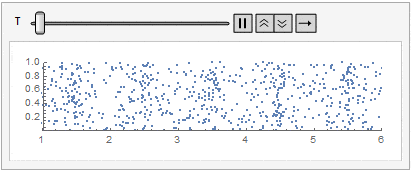

TP9109 said:
does that mean the "thickness" of the strips would be increased
They don't have a specific "thickness", the pressure has a gradient, and for a louder sound the pressure difference and so the pressure gradient are steeper.
TP9109 said:
I'm struggling to visualise how that higher amplitude would appear in the animation?
The peaks would be more concentrated for a higher amplitude wave.
Low amplitude:
High amplitude:
Likes sophiecentaur, Ibix and berkeman
