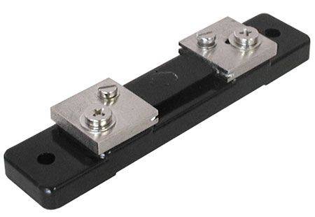

Also Jim Hardy I did find a AC/DC amp probe but they were over $200 bucks. I happened along something that I want to try instead and that is a Shunt Resistor that I ordered for $5 that has a design voltage and resultive amps that according to what I read can be used in conjunction with a volmeter to measure my line amps.
This shunt is designed such that the voltage drop across it is X mV when the current flowing through it is X Amps.
Therefore one can calculate the 'design X value' ohms resistance of this shunt to be design voltage divided by design current = XmV / Xamp = X design ohms. (typically to within ± 0.25% accuracy).
Therefore if doing an in circuit test with this shunt, a voltage drop . . . . of say 28mV is measured using a standard multimeter, we know (by ratio math) that the current flowing is 0.028/'X design' ohms = Test Scenario Amps. Correct ? or did I totally miss this one ?

you have it exactly right i think.
one milli-ohm (0.001 ohms) shunt will produce one milli-volt per ampere
ohm's law: volts = amps X ohms; volts/amps = ohms; volts/ohms = amps .
0.028volt / 0.001ohm = 28 amps
be aware your starter shold pull a couple hundred amps so feel of your shunt after a very short crank and make sure it doesn't overheat.
Hopefully your shunt is one of the real stout ones, heavy brass ends connected by flat blades sort of like a venetian blind, about 3-4 inches long overall.
One practical point - the shunt should have four terminals.
Apply current between outsiide two, measure millivolts between inside two.
That way your millivolt reading does not include contact drop across your current connections which would be an error.
