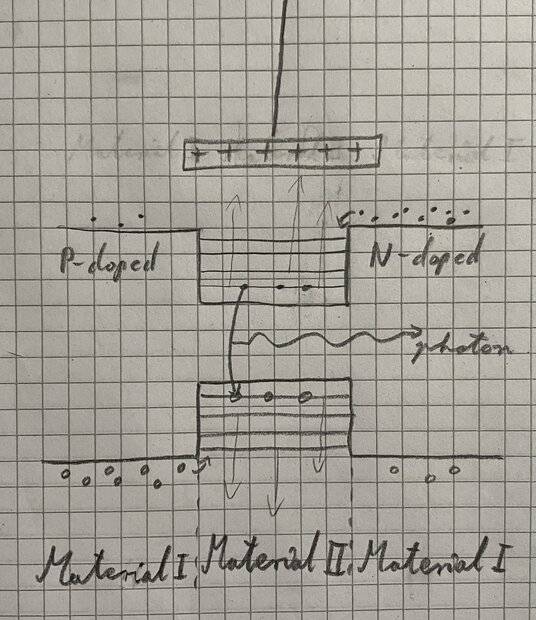

How can one use a quantum well to change the colour of emitted light from an LED without changing the semiconductor material?
Hi!
This question is translated so that's why it might sound a bit weird. I know that the answer should mention the band diagram of the LED, and I think that the answer is to introduce an electrical contact connected to a voltage source. Then when you increase the voltage, it should attract the electrons from the quantum well, and repel the holes from the other well, thus increasing the band gap and increasing the emitted light's energy (different colour). And vice versa for a negative voltage.
Am I correct?
I am no longer "cutting edge" for LEDs but I am unaware of practical examples of this technology. Does anyone have a real-life example of this idea?
