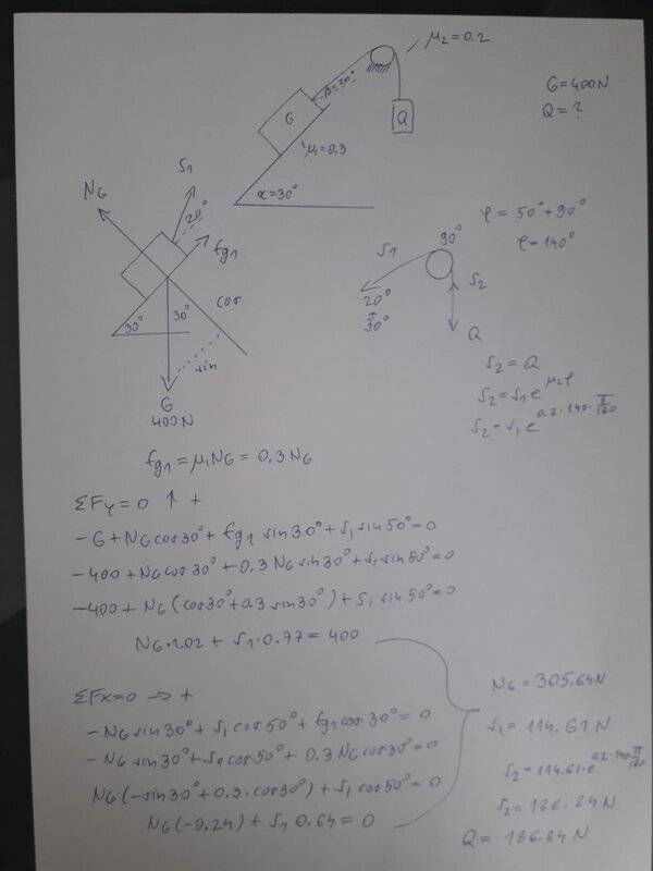

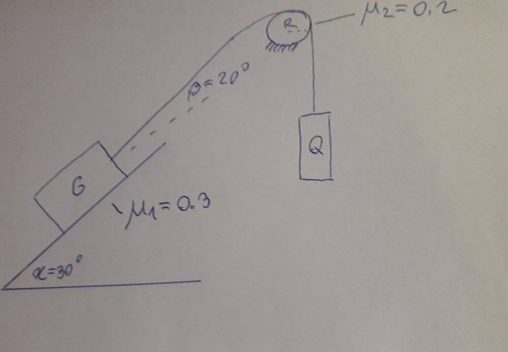

If given G find weight Q necessary for a uniform descent of G
Fx=0
Fy=0
This is my attempt of solving it

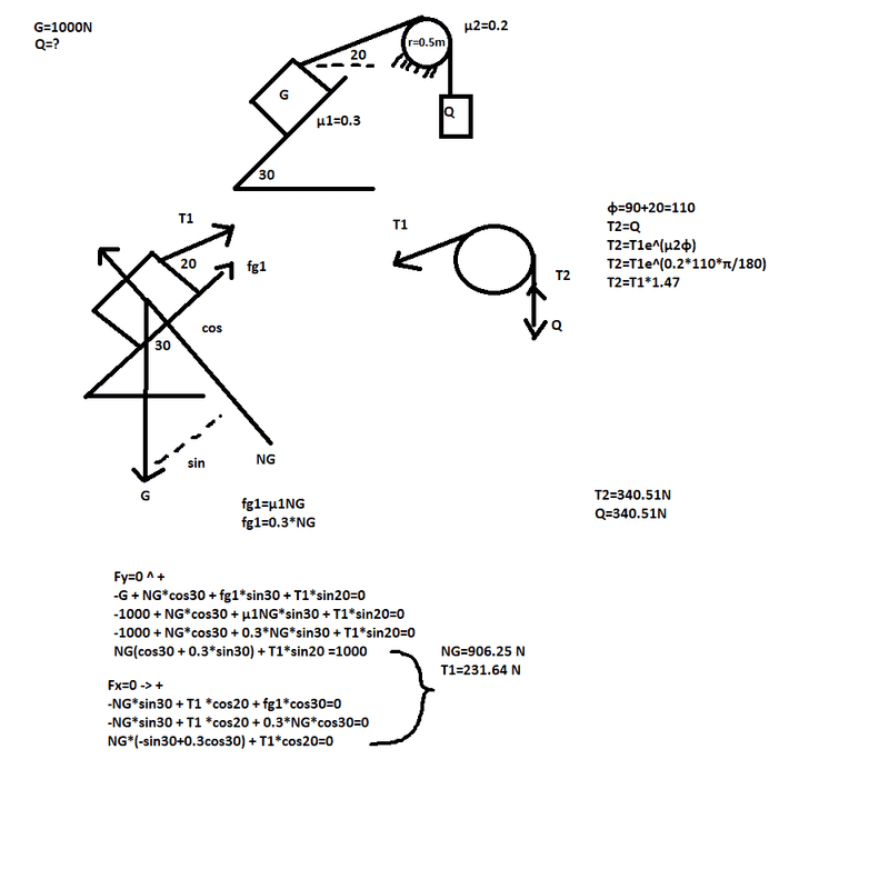

The angle between the string and the face of block G does not look like 20o to me. You will have to recalculate the components of the tension perpendicular and parallel to the incline.
It is given as 20 but my drawing is not faithful
it looks more like this
or should the angle of T1 be 50 due to the slope being 30deg and the rope 20deg so 50deg
and that means angle around the pulley is 50+90=140deg
Yes.
But the block cannot descend uniformly since that angle will change.
Okay but without the unfiorm descent would this be it
Looks right.
