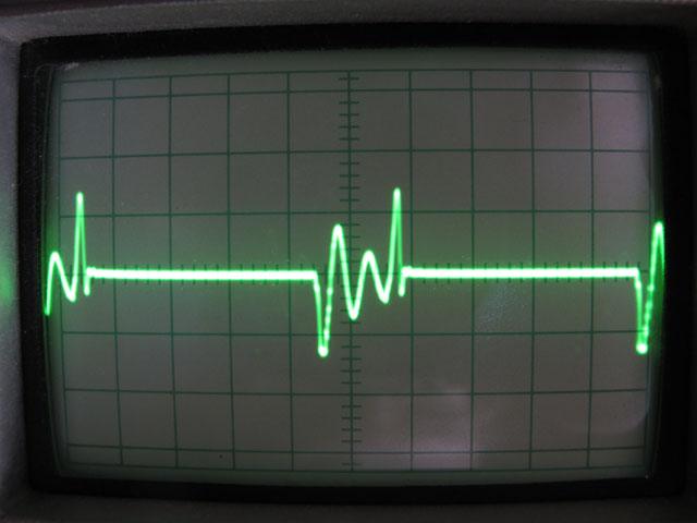

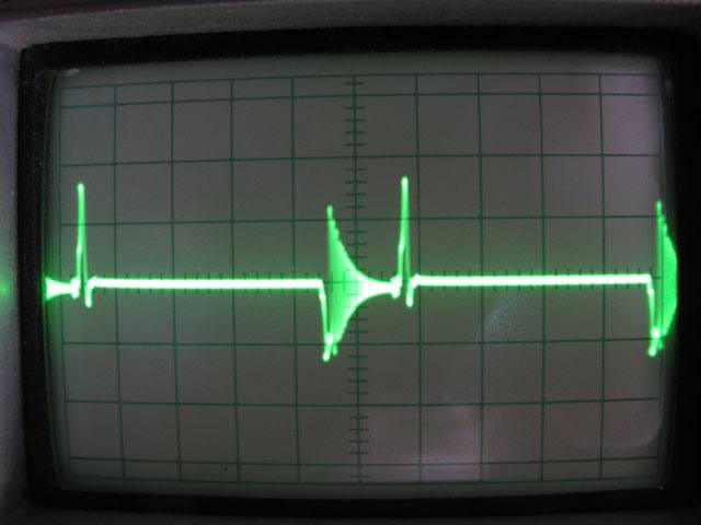

There was a lot of ringing at the switch node - meeting point of the diode, inductor and MOSFET.
5.8Mhz clear decaying sine wave, got rid of the most of it with an RC snubber - 5Ω, 10nF.
There is still, however, a big peak at the moment the switch closes.
15.5V 7.75A out, 12V 10A in (20V vertical)
21V 10.5A out, 20A in.
The spike is already at nearly 60V.
At this rate the spike will exceed the 100V rating of the transistor well before the 100A maximum input current i was aiming for.
There is a TVS diode across it, but i doubt it would help much to prevent the explosion.
Is there any way to get rid of this spike?

The traces above are measured across the mosfet, with probe and ground connected directly to it's bolts.
Assuming switch=mosfet, the voltage is at the output level when it's closed, and drops to zero when it conducts.
As the switch closes there is a spike.
The ringing was that spike being a decaying sine wave.
The current should not die out - it runs in continuous mode at any interesting load.Moving the ground around do not produce any drastic changes.
Across the output capacitor there is a bit of bursts of ringing, +-1V or so, coinciding with opens and closes, it does seem to reduce if i add various small capacitors to it.

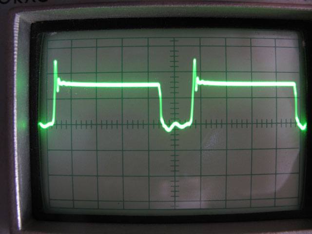

Now, that did something.
Things started happening at 100nF, film cap across the diode.
Before:
FET, 2us, 10V.
Output, 2us, 1V.
After:
FET, 2us, 10V.
Output, 2us, 1V.
Not all the way, making different oscillations, and heating the capacitor noticeably, but feels like progress.
Is there any theory behind what capacitor to choose, and how much heat to expect on it?
And where can that new ringing be coming from?

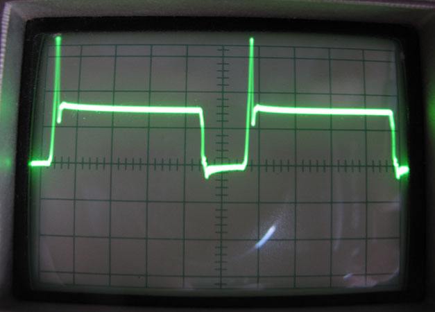

One more thing - it's the ESR/ESL of the capacitor that matter, not it's value.
Same 100nF, but as a quality X2 capacitor:
Looks almost perfect, spike-wise.
However, i don't like that low frequency ringing that is now all over the place.
The problem is the turn on time of the diode is too slow. When the FET turns off the inductor must still conduct. But there is a finite amount of time for the diode to go from non conducting to conducting. So the inductor just keeps pushing charge into Cj of the diode until it can be drained out. Because Cj is small and I is large there is a lot of V. (You can confirm this experimentally by varying the Idc in the L and observing the peak change. If you have a load R vary it.) By putting a cap in parallel with the diode you increase the C but Q stays basically the same so there is less V. (Note: you have to be able to access the C. If there is excessive ESR or ESL the C cannot be accessed by the high frequency I induced by the switch.)
In general this is not a preferred way to damp the peak compared to a switch node RC snubber because I think you'll notice the efficiency of the conversion just went way down.
The snubber should've worked. It's purpose is also to provide an escape path for the inductor current while the diode is turning on (some people think of it as an AC short, or damping the LC, its all just different sides of the same coin in my opinion).

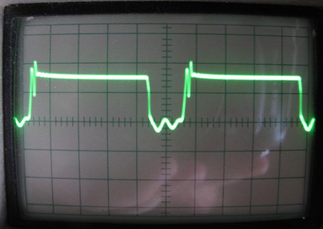

Moving the snubber to input ground makes a bit of a difference, but not really significant. Having two snubbers - one on DS, other D to input ground seems better than either alone.
High frequency noise on the diode is cleaned up by adding an RC snubber across it - 3300pF, 15Ω. That one also contribute a few percent reduction to the spike.
Changing all snubber caps to MKP X2 shaves off another percent or two.
The biggest effect, however, is adding a capacitor from the output end of the diode straight to the input ground - 2uF MKP X2. That reduces the spike at the MOSFET about as well as the capacitor across the diode did, but without additional ringing. The bigger this one is - the better, but above 1-2 uF it no longer change much.
Bad news about it is - at high power it heats a lot, and the spike turns into a full scale calamity.

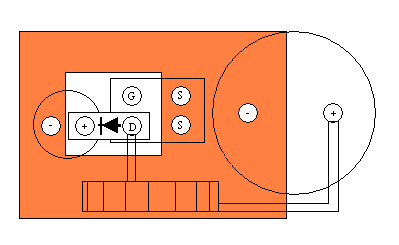

I was expecting current layout to be final, but it seems like there is no fixing it like it is.
Any advice on how to lay it out? I can't quite visualize it on a PCB when even 4mm wires are warming up.
I do have a 2mm thick sheet of copper, so maybe use it as a ground plane, and mount everything in it's line?

Your input capacitor at 100,000 uF is unnecessarily huge with lots of inductance. I am surprised it is needed. Surely 1000 uF would be more than enough. If your input leads are very long then a Pi input filter should be a better investment as it will offer lower impedance at the switching frequency.
The 6800 uF output capacitor is much too inductive for that application. It needs to be paralleled with a small fast high current capacitor to catch the switching edge. Big capacitors are not better for spikes, they are far worse. Big capacitors are good for ripple. Use two different capacitors for the best of both worlds.
Since the transition that causes the problem involves only the 20 uH inductor and the fast diode the best way to snub the spike is to put a capacitor across both those components. That would be between the (+)input and (+)output and would divert the spike from the ground inductance into a much smaller current loop. The capacitor need only handle the spike so an 0.1uF disc ceramic, possibly in parallel with a metallised polypropylene suppression capacitor should eliminate most of that spike.

With ground at input, there are spikes all around.
Slight difference between D and diode, some at the output.
Most interestinngly, there are ~4V spikes across the return wire from the fet's source, and 6-7V of spike across the return wire from the output (10A input).
Literally that - a clip is on one end of a thick wire, the probe is on the other, and there is a spike showing up at both closing and opening time.
I reckon that's not good.
Capacitors:
Placing any capacitors (0.1 to 100uF aluminium, film, ceramic) across the output or input ones does not do anything i can see.
However, adding capacitors with direct wire to the input ground makes a lot of difference.
X2 caps in 1uF range produce waves you can see in video #2, and reduce the spike somewhat.
Aluminium in 50uF range reduce the spike half as good without adding any waves.
Tried from diode to input -, from output to input -, and from diode to input +, effects are similar.
Based on earlier tests i expect these capacitors to heat up a lot.
1uF X2 cap from output + (near diode) to input ground got it's leads so hot at 80A input that they desoldered.
Choice of capacitors:
Output capacitor is so big for thermal reasons - smaller tabbed ones in 100-1000uF 100V range were heating up rapidly even at medium power levels, so i picked up the smallest 100V bolted capacitor available, and that one stayed cold.
Input capacitor was picked essentially at random, to fit the height of the output one - from what i heard, too much input capacitance should not hurt and will spare the battery from current spikes, but i didn't do the math on how much is enough.
With switching converters the capacitor choice is based on ESR and ripple current. That is what cooks them.
Use only as much capacitance as needed. If you use twice the capacitance needed then the temperature rise of the capacitor will be four times greater. There is no advantage in using the biggest one available that will fit, it will have been designed for 10msec cycle time ripple, not 10usec cycle ripple.
There are special capacitors for switching semiconductors, designed to bolt on.
Your problems with spikes will go away when you realize the importance of capacitor internal connections. You are dealing with currents up to 200A and so cannot expect commodity capacitors to work. Your converter is operating in the domain of welding equipment.
Borrowed an LCR meter.
The 6800uF bolted output capacitor have about 0.2Ω of ESR at 100Hz, and refuses to measure above that.
Smaller 1000uF one i tried before with a lot of heat have 0.035Ω at 100Hz, 0.2Ω at 1kHz,1.6Ω at 10kHz, and at 100kHz it shows 2uF and 1Ω ESR, which is either wrong or way out of band for that capacitor.
Tried to replace the output capacitor with a 100uF film pulse discharge one, known to be non-inductive and with ESR of under 0.001Ω at 100Hz.
With it, there is no visible ripple at 10A 20V output, and it stays completely cold.
However, there is pretty much no effect on the spike at the MOSFET.
So, i think the problem is mainly in the wire inductance, rather than the capacitors.
