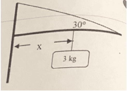

A 3 kg cafe sign is to be hung from 1 kg horizontal beam such that it is in equilibrium. The beam is 4 m long. A wire is attached to the beam at its right end to prevent the sign and the beam from rotating. The beam is pressed against the wall on its left end and is prevented from sliding by a bracket that is fixed to the wall.
a) What is the tension force in the wire ?
b) What is the normal force of the wall pushing against the left end of the beam ?
c) What is the upward force supporting the left end of the beam ?
d) How far from the wall should sign be hung so that it is in equilibrium ?
240770
Now following is my attempt at solution. Let ##T## be the tension in the wire and ##\theta = 30 ^{\circ}## be the angle made by the wire with the horizontal. Let ##F## be the upward force supporting the left end of the beam and ##N## be the normal force of the wall pushing against the left end of the beam. Let ##L=4m## be the length of the beam and ##M = 1 kg## be the mass of the beam and ##m=3 kg## be the mass of the cafe sign. Then the condition that the net force on the beam is zero leads to the following equations
$$ N = T\cos(\theta) \cdots\cdots (1)$$
$$ F + T \sin(\theta) = Mg + mg \cdots\cdots (2)$$
Now, the net torque about the right end of the beam is zero. So this leads to the equation
$$ Mg(L/2) +mg(L-x) - FL = 0 \cdots\cdots (3) $$
Also, the net torque about the leftend of the beam is zero. So this leads to the equation
$$ T \sin(\theta) L -Mg(L/2) - mg x = 0 \cdots\cdots (4) $$
Now, it seems that, these four equations are not sufficient to entirely solve this problem with four unknowns ##F,N,T,x##. I just get three equations and 4 unknowns after doing some algebra. So any hints here ?

Okay perhaps I understand your question. Part d) suggests there is only one position ##x##. But, surely the system supports the sign whatever ##x## is.
Is that your question?

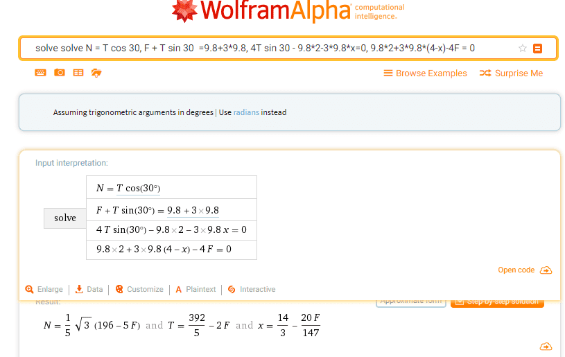

I use Wolfram Alpha to solve these 4 equations and it gives me answer in terms of ##F##.
240793
This means that with my equations, the problem can not be solved completely. Probably, some information is missing in the problem or I am overlooking something.
Perhaps this means that the beam is supported from underneath by the bracket and the beam's end at the wall is prevented from sliding down but can slide up. In other words, the vertical force ##F## exerted by the wall can be directed up but not down. The value of ##x## at which ##F## changes sign
is what you should be looking for. Anyway, that's my interpretation.
I am not seeing how that makes much physical sense. In order for F to change signs, x is going to need to exceed the length of the horizontal beam.
Mathematically, that is no problem. But physically, it is tough to hang a sign under a portion of a beam that is absent.
Edit: The solution from Wolfram Alpha contemplates just such a configuration -- set F=0 and see what x evaluates to.
If we plug ##F=0##, then ##x = 14/3 = 4.67m##. This is longer than the length of the beam. So its not a possible solution. I think some information is probably missing from the problem. All 4 unknowns can not be solved.
Right you are. I was thinking of another problem where the wire is not attached at the tip, but at some given distance from the wall. Part (d) doesn't make sense the way it is written because one has to assume that the rod is in equilibrium to do the previous three parts.
