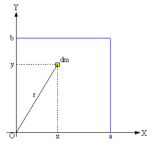

Okay, here's a drawing showing a flat rectangular plate comprising the area bounded by the coordinate axes and the blue line. Width is a, height is b. Assume the density is [itex]\rho[/itex], and that we want the moment of inertia about an axis passing through the origin. How would you set up the integration to sum all the [itex]r^2 dm[/itex]?
Ok, the only possible way (at least for me) is performing a triple integral. This integral, however is easy to solve, but a bit tedious.
Make r^2 = x^2 + y^2. Integrate dm = p dV over the region ocupied by the cube (the limits of integration are 0 to L for all three axis). Remember that dV = dx dy dz and p is constant.
To gneill, I would say density=ρ=M/ab
so what şs dm equal to ?
Is it dm=ρ*x*y

[itex] dm = \rho \; dx \; dy [/itex]
r2=x2+y2
r=sqrt(x2+y2)
