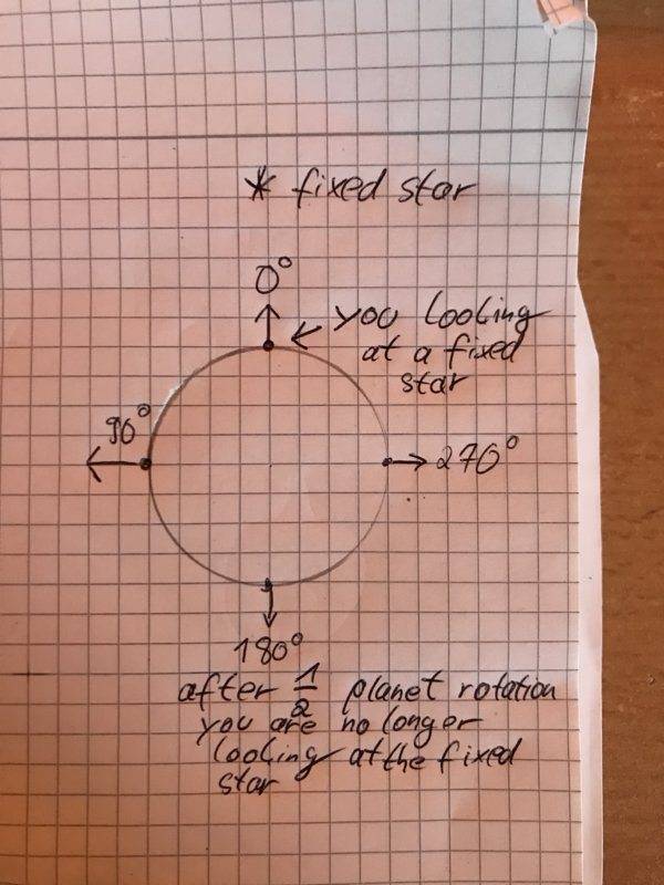

Look at the picture. Before the rotation you are looking at a fixed star.
After 180° you are looking in the opposite direction.
Isn't one planet rotation like one rotation on a office chair?
This is getting goofy. Of yourse you can see that the Earth rotates. But that's not what you asked.
Yes, we know what rotation is.
In some ways, yes. In what way are you referring to? What exactly is it you think you would feel? Please answer - I asked this before. We can't tell you if your understanding is right or wrong unless you tell us what your understanding is!

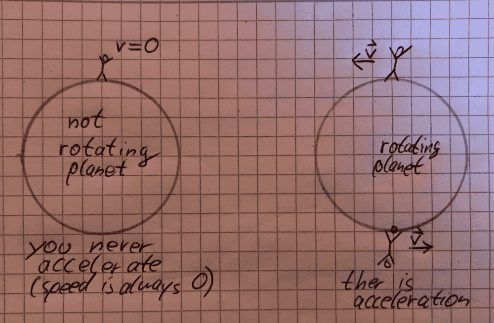

Let's assume you have a acceleration sensor (as there is in smartphones).
Of course you need high precision.
You start the measurement at midnight somewhere on the equator.
After 12 hours the Earth rotation has accelerated you and you are now traveling with the same speed but in the opposite direction (see my previous drawing).
The sensor has recorded this acceleration regardless of what caused it.
If the sensor can feel this why should the human body not be able to feel it?
Of course the Earth rotates very slow. But on a planet rotating once every 3 seconds?

No I'm not talking about g-force! I wrote g=9.81. I thought because of the value it should be clear what I mean.
I've looked up Earth rotation speed. It's 464 m/s.
So when you are now traveling with 464 m/s then after 12 hours you are traveling at -464 m/s.
That's (464*2)/12h m/s = 0.02 m/s²
So in 10 seconds it's an acceleration of 0.75 km/h.
I think I'm right and the Earth rotation is simply too slow so you don't feel the force.

This is some kooky kinematics here that you are using. The "acceleration" is directed toward the center of the circular motion. This calculation is faulty.
Secondly, this "earth rotation speed" is vague. On what latitude is this? This speed is not a constant at all location! Someone at the pole of the rotational axis will have zero speed.
There are very serious errors in understanding of basic kinematics here.

somega said:
Why should it not be possible to feel this?
The effect is there but it's too small for us to feel. Something similar happens when climb to the top of a tree - the force of gravity on us is very slightly different but not enough for us to notice. Sufficiently sensitive instruments can detect it however, and likewise a device like the Foucault pendulum that @wrobel mentioned above will detect the rotation of the earth
I think I was wrong.
I forgot that if the speed remains the same and the direction changes then there's no force.
And so there's nothing to feel!
This is wrong. If the speed remains the same but direction changes, there IS a force. Central forces are exactly THAT! Look up "centripetal force".
