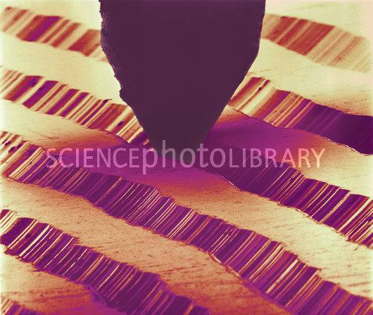

The record grooves have modulations, they wave back and forth under magnification, they have bumps on their walls.
A constant downward force of about 2grams is applied by the tonearm.

Yep - you need to draw the forces on the needle-point as if in a smooth groove wider than the point.
Without a balancing force, the needle will rest on the outside edge of the groove - so this is providing a radially inwards force. But the needle does not do circular motion with the record! Instead the needle has a radial motion because the groove is a spiral.

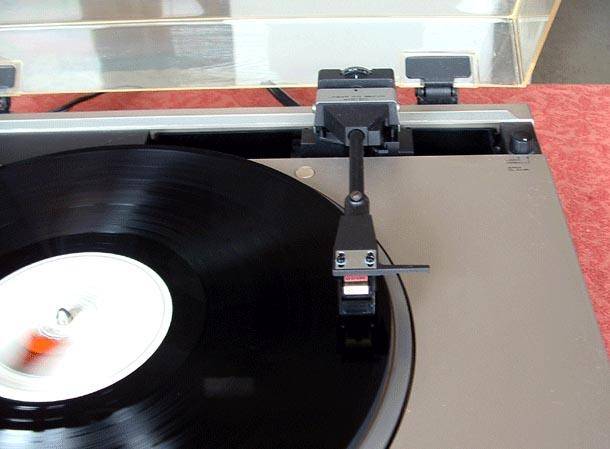

One alternative to this is / was to use a linear tracking tonearm. The tonearm was mounted so that it could move perpendicularly with respect to the record grooves. One method was to mount the tonearm via a bearing onto a thin and long (a bit over 1/2 the size of a record) rotating cylinder (the tonearm would be perpendicular to the rotating cylinder).

Or far easier, a tangential tracking table as mentioned above. They can be a bit tricky to adjust though.
jamuses said:
In theory, a servo mechanism could be constructed that variably adjusts antiskate in real time based on the audio output. Or far easier, a tangential tracking table as mentioned above. They can be a bit tricky to adjust though.
Image of an example of a linear tracking tonearm (there are several methods of implementing these: servo, rotating cylinder bearing, air bearing, ... . Tangential tonearm is an alternate name for these).

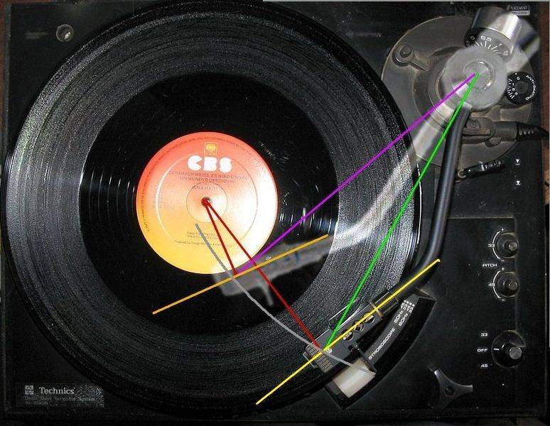

Out of curiosity I drew the lines on that picture (showing the arm in two places):
... I think this is quite clever actually.
At first I thought that the tangent and the moment arm would line up close to the hub - but from above, they seem to form about the same angle right through the motion. That's cool.
Note: in case it is not obvious...
Red are radial lines, the grey line is the arc.
Yellow and off-yellow are tangent to the rotation.
green and magenta are the moment arms at each end of the motion.
You can see how the unbalanced force comes in.

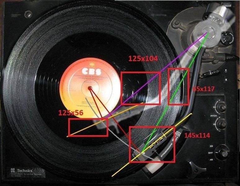

Crunching the numbers, I get 157.23 degrees for the outer, 164.37 for the inner angle. Highly doubt the picture is taken from directly above
though.

You could work it out from the standard dimensions of the record.
If you used my lines - those were lined up by sight and I only noticed the similarity in the angles after I'd killed the xcf.
There are quite a lot of intreguing relationships there - like the initial radius (long red) is perpendicular to the final moment arm (magenta).
