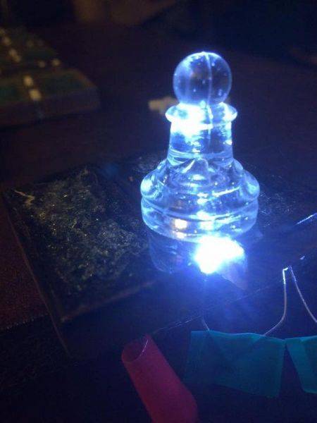

I'm planning to light up a tile chess board with 64 LEDs (blue and white) set between the tile squares, and I was wondering if this Class 2 Battery charger output: 12VDC 900mA, would work to power 16 parallel sets of 4 LEDs + 1 ohm 1/8W resistor and a SPST toggle switch? The current drawn by the circuit should be around 320 mA according to this: (http://ledcalculator.net/default.aspx?values=12,3,20,64,0).

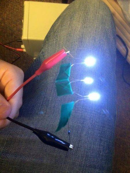

I can see if I have another battery charger lying around somewhere. I also have a 30VDC 5A adjustable power supply that I can use to test things.
Would it be possible to just use lower voltage? I tried using a single LED with a two C battery pack and it lit up fine.

I didn't mean doing a bunch of single LEDs though, I meant along the lines of treating the LEDs as 3 volts instead of the 3.2-3.4-3.6 since the lone one seemed to work fine with the 3 volt battery pack. And then go with the x3 series stack you mentioned earlier with the 12 volt. They'll only be a bit dimmer if the voltage is a bit low, right?

If you still want to roll your own with resistors, then three LEDs in series at 3.6v gives 10.8V worst case, so the remaining 1.2V across 60 ohms gives 20ma.
(note that the remaining voltage and the resistor is what sets the operating current)
64/3 =~ 22 strings @ 20ma = 440ma
But, if the 3 LEDs were 3.2V , that gives 9.6v, so then you would need 2.4v/.02ma = 120 ohms to limit the current to 20ma.
So, depending on the LED's voltage (which varies from led to led) you would get different currents.
I would try 12V driving 3 LED's with a 120 ohm resistor (this will give between 10 and 20 ma depending on the LED drop). You can then play around with your variable supply and decide on a final resistor value.

Late reply, sorry.
I just got the 120 ohm resistors in the mail so I'll try them out. Thank you for the help :D.
Yup looks like it'll work, thanks a bunch guys.
