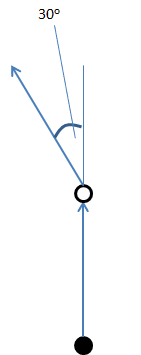

I have an exam on collision and projectile motion tomorrow, and was wondering if anyone could answer this question: I get an answer, but my friend gets a completely different answer. I was wondering if anyone could just clarify and show us the correct answer. All help greatly appreciated. Thank you for your time.
A black billiard ball travels up the centre line at 1.5 m/s. It's mass is 250g, it strikes a white ball of the same mass which is propelled at an angle of 35 degrees to the left of the original direction of the black ball. The white ball final speed is 0.9 m/s. What is the final velocity of the black ball?

Could you please post a picture showing the directions and θ?
I've attached the file.
Edit: Sorry the angle should be 35.

Dreaam said:
(0.25 * 0) + (0.25 * 1.5 cos 90) = (0.25 * 0.9 cos 125) + (0.25 Vb cos θb)
0 = -0.13 + 0.25 Vb cos θb
You shouldn't still have a .25 in there.
Here's a really good piece of advice: work entirely symbolically until the last step. Only then plug in the actual numbers. This makes it much easier to find mistakes and for other people to follow what you are doing. In the above, you might then have spotted that the dimensions didn't make sense, having removed mass from all except one term. It also helps to preserve precision and minimise calculation because you often get cancellation in the algebra.

You've jumbled up sin and cos mate. x-component will have sinθ and y-component will have cosθ. Change that and solve again.
Dreaam said:
Thank you for your feedback haruspex, my question is: even if I included the 0.25 values, wouldn't the outcome still be the same?
No, it is an error that will change the answer. You canceled the 0.25 out of three terms but missed the fourth. You made the same mistake in the y direction.
siddharth23 is also right - you've mixed up sin and cos on the RHS of your equations.
