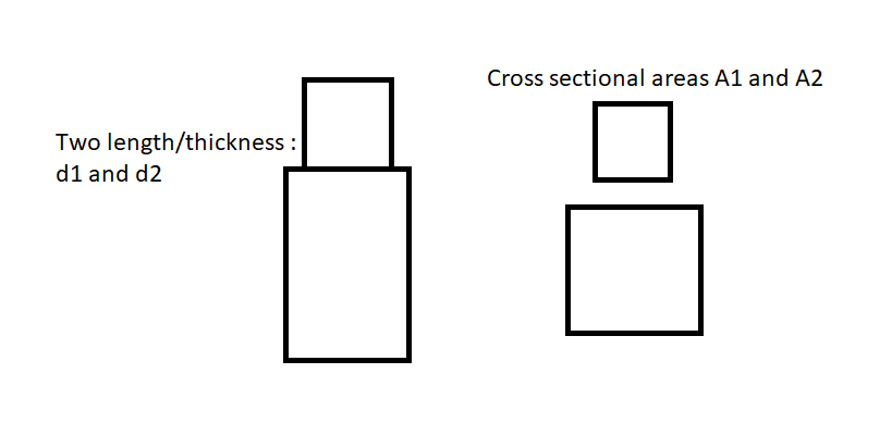

Conduction heat transfer with varying cross section
In summary, the conversation discusses calculating the conduction heat transfer between two parts with different temperatures and geometries. The equations for heat conduction in each part are given, and the goal is to find the conduction heat transfer Q.
imselva
How to modify this Formula? and arrive at the solution.
Q = -K(Th-Tc)A/thickness
Science news on Phys.org
I don't understand the geometry you are trying to specify.
The geomentry consists of two parts in complete contact with each other.
The first part is a Stadium shape with 5 mm thickness and a height of 39.4mm.
The second part is also Stadium shape with 0.9mm thickness and a height of 64.8mm.
The Bottom of the first part is at 1020°C and the top for the second part is 20°C.
I want to calculate the conduction heat Transfer between the two different temperatures. How to find Q?
View attachment Unbenannt.PNGThe temperature T1 at the top Surface is 1020°C and T2 at the Bottom Surface is 20°C and K is the thermal conductivity of the material.
What is the conduction heat Transfer Q. ?
Let T be the temperature at the junction between the two parts. Q is going to be the same through each of the two parts. In terms of T, what are the two heat conduction equations for each of the two parts?
Q1 = (-K*A1*(1020-T))/d1
Q2 = (-K*A2*(T-20))/d2
Q1 and Q2 are both Q. Eliminate T between the two equations.
