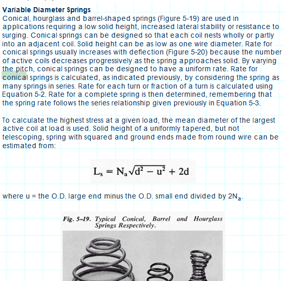

Here is a useful paper about springs, where they show an equation that you can use for the spring force as a function of extension for a conical spring:
http://www.faculty.fairfield.edu/wdornfeld/ME311/AssocSpringBarnes-SpringDesignHandbook.pdf

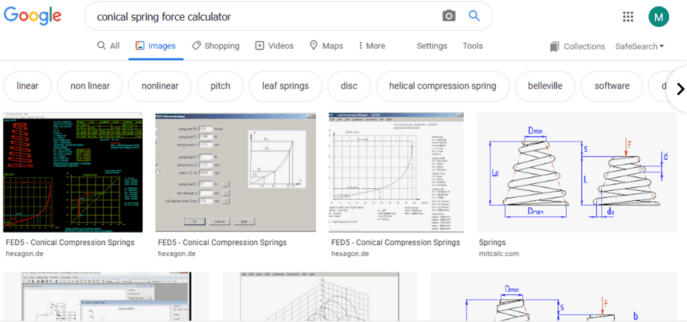

I also found that there are Conical Spring Force Calculators with a Google search:
https://www.google.com/search?q=con...mg&ei=KIm5Xve6PNO0-gSsh7qQCQ&bih=540&biw=1110
