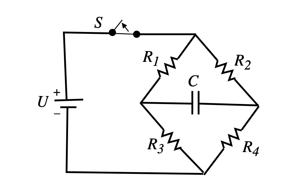

Discharging this capacitor in an RC bridge circuit
In summary, the voltage source in the circuit below has been switched on for a long time when the switch S switches off. How long will it take before the current coming out of the capacitor has become less than 1 mA?

The voltage source in the circuit below has been switched on for a long time when the switch S switches off. How long will it take before the current coming out of the capacitor has become less than 1 mA?

Hi, I edited the thread. We are assuming that current from the capacitor at the start of discharge is at least 1mA
You could have solved it more quickly by looking at the steady state after the switch is closed. The currents through R1 , R3 and R2 , R4 become constant defining the voltage difference across the capacitor.
On the discharge The capacitor is shunted by R1+R3 in parallel with R2 + R4 .
