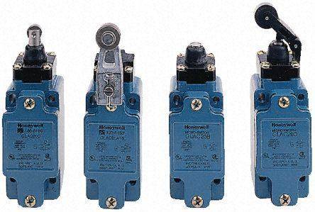

For reasons beyond understanding, I'm trying to source an industrial limit switch to control the power to a desktop PC. It's run on a switch mode standard computer PSU.
Most of the limit switches I've looked at are rated 5 amps @ 220 VAC. But they also have an AC-15 rating usually much, much lower, perhaps as low as 0.2 amps. I think that AC-15 applies to electromagnetic loads. Does this include PCs? They don't have much in the way of transformers...
Otherwise, how can I use a limit switch for controlling my PC?

Something like (but not limited to) one of these:-

The nub of the question. Does power category AC-15 include a desktop PC?
I have to rule out relays as this switch will form the mains isolation switch, so there's no power to drive a solenoid... :frown:
some guidancehttp://www.nkkswitches.com/pdf/electricalratings.pdf
Inductive load stresses the contact on opening. The arc is difficult to extinguish.
Capacitive load stresses the contact on closing. Huge inrush current flows while the contact is still bouncing..

Thanks Jim, just read this. Looks like I'd be better off using a relay somewhere. This means I'll have to rethink my isolation layout.
Thought: Why then do domestic socket switches not have usage categories? In the UK, they're all rated 13 amps. Doesn't matter if you're switching a welding machine, most powerful vacuum cleaner in the world or fairy lights.

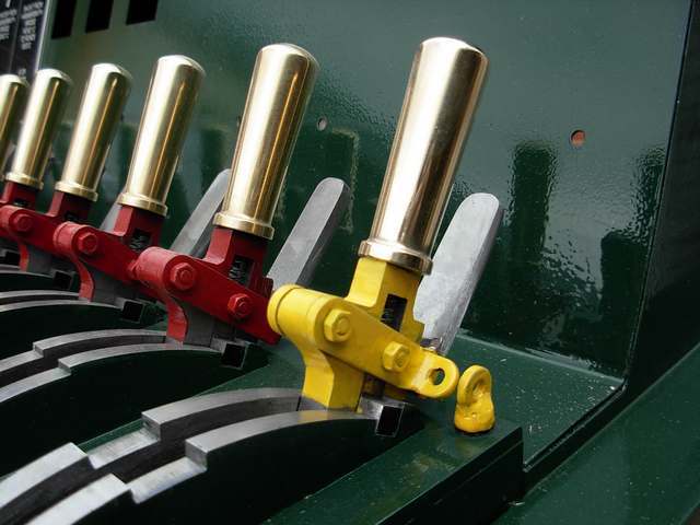

I'm building a pc in the Steampunk style. It will have a large lever on the side to turn it on, based on :-
There will be two power supplies and other mains equipment inside the computer case, so I'd like an isolation switch upstream of all of this. It would be really cool if the lever switch actually worked for real as the isolator. Just like in those mad scientist films. The limit switch would be the switch operated by the lever's shaft. As it's the isolator, there's no other power available for relays, mosfets etc.
My plan B is to connect the lever at it's fulcrum to an industrial 16 or 20 amp rotary switch such as:-
If I can't reliably attach the lever to this switch, I'll have to fall back to plan C and go with a normal toggle switch isolator,, and a relay /limit switch combo to get the lever operational somewhat. This is the least preferred option.

Another option is to arrange for your steampunk lever to flip a standard light switch internally.
BoB
not a bad idea. Cheap and easily replaced.
