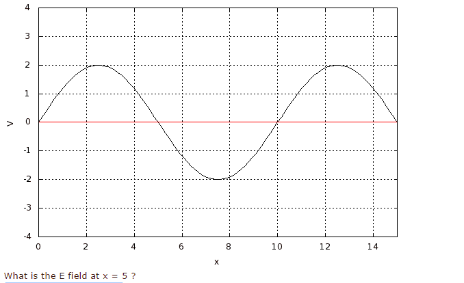

E = -dV/dx ?
not really sure how to do this problem. I think I understand E field is negative of slope of V/x, but I'm getting it wrong. just looking at it, I see V=-2 at x=7.5. so the E field to right of x= 5 is y2-y1/x2-x1= 2/2.5 = 0.8. to the left of it I guess it's -0.8 (V/m). I tried both answer but its wrong.

Finding the slope is the correct approach. So in that respect you are on the right track.
But the way in which you are going about finding the slope is too inaccurate. There's a better way.
Can you express V(x) in terms of a sine function? In other words, if
V(x) = A sin(kx),
can you find A and k ?
oh yeah, I didn't think of that. V(x) = 2*sin(0.2*pi*x), so I guess I take the derivative of this to find E field? dV/dx = 2*0.2*pi*cos(0.2*pi*x), and at x=5, E=-dV/dx=1.26?
That looks correct to me! :)
