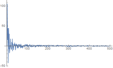

By the way, as a follow up I investigated this for the "background" population that I described above. Since I used a starting value of 1500 we don't expect the same numbers, but I was curious.
For the middle background player the average increase was 2.3 and the average decrease was -2.0. For the top quarter player it was 2.2 and -1.8. For the bottom quarter player it was 1.8 and -2.3. For the second player it was 2.2 and - 2.5. For the second worst player it was 2.8 and -2.2.
Now, all of those were over the full 1000 matches that established the background rankings. The process itself is highly dynamic so an overall average number is not that informative. Here is a plot of the ranking changes over time for the top quarter player.
While the ranking is uncertain the changes are large and rapid. As the ranking becomes more certain the changes become smaller. This dynamic behavior is what actually drives the algorithm. Compare the averages over the full 1000 matches to the averages over the first 5% of the matches: for the middle player it was 30 and -16 in the first 5% compared to 2.3 and -2.0 overall. For the top quarter player it is 29 and -13 compared to 2.2 and -1.8. Similarly for the others.
Now, you can always take any rating and win/loss history and generate an average increase and an average decrease. That is completely irrespective of the algorithm used to generate the ratings. So to simply look at an average (which can always be done) and claim that it tells you anything about the algorithm is nonsense. You cannot use such data to claim that "what Glicko was counting is (initial amount)+8(wins)-8(losses), i.e. wins-losses". If that were the case then the change would be consistent over time and consistent between players, neither of which is true.
This whole thread you have been misrepresenting the Glicko algorithm. It simply does not do what you say it does.
