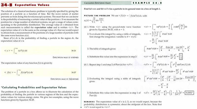

I made some pictures of the related parts from the book, if it helps:
