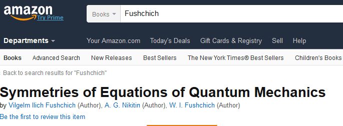

Actually, Pauli's equation is the simplest Galilei-group invariant wave equation, just in the same vein as the Dirac one is the simplest Poincaré-group invariant group equation. There were/are two famous Ukrainian physicists, Fushchich and Nikitin who wrote a whole book on group-theoretical derivations of wave equations
That is very interesting, and makes a lot of sense since the pauli equation seems to be the nonrelativistic limit of dirac equation.
Thanks, I will definitely take a look on this group theory derivations.
