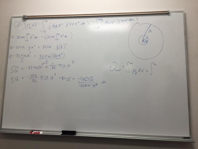

Here is some of work to give you more insight to where were at.
Your integration appears (it's hard to make out in the image) to be assuming a charge density of -8αr2 over the entire region from 0 to a. Yet the shell is hollow and there is no charge in its interior. The lower limit of integration should begin at the inner edge of the shell.
Integrating like that would get us the same thing as if we used two different integrals.
Alright. I was a bit thrown off by the '5' that looks like a stylized 'S' in from of the Q . I though it was a shorthand for "sum of" or something similar.
So with a expression for the total charge you can write the expression for the magnitude of the electric field external to the shell.
Now you'll need to re-do your work to find an expression for the charge interior to a given radius...

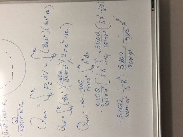

Does that look correct to you? Sorry about that. I'm looking at that and that totally looks like an S haha
Looks okay so far.
