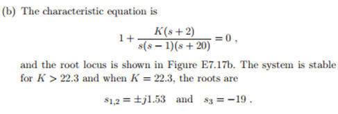

Hi,
In the attached image the roots are shown for the characteristic equation. I don't know how the roots were found. Anyone able to help?
Thanks
Splint
When drawing the root locus you need the closed loop poles. So I'd suggest looking at the closed loop G(s).
