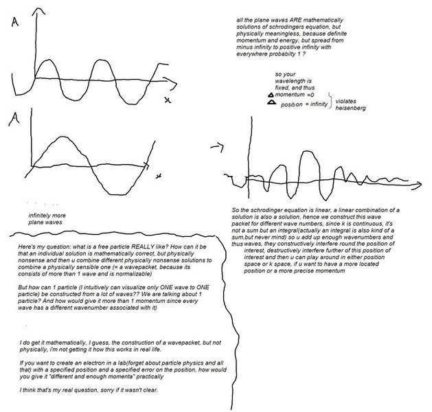

I've read all your posts a while ago and thanks for that. But I still haven't got an answer and wasn't sure how to really explain what I want to hear.
I think I want to know what it means for the free particle to composed of more than 1 wave and how would you do it in a lab theoretically speaking. A free particle in a lab, how to create an electron that is free with a specified location. Theoretically speaking, because not a single one electron is free. So, how can u play around with momenta? How can u create a wavepacket in practice with enough different wavenumbers to localize it in reality?
Conceptually and practically. Are we also still speaking about 1 particle if it's made up of more than 1 wave?

The answer is simple: You cannot prepare an electron with a definite momentum, not even theoretically, because plane waves are generalized functions and not square integrable ones that represent states of real particles. What you can do, however, is to perpare particles with a quite well-defined momentum. The uncertainty relation tells you that this is at the cost of the precision in the electron's location.
In practice, what's done is that you feed electrons into a particle accelerator and accelerate them with electromagnetic fields. What you get in reality are bunches of electrons with a quite well-defined momentum. You can use filters to filter away electrons whose momentum deviates too much from the value you like to prepare.
Of course, you can describe any wave as a superposition of plane waves, the socalled Fourier-decomposition. The corresponding wave function is given by the Fourier integral (see my posting above)

Hi Waxterzz. I enjoyed your free hand drawings.
As for one particle- one wave, I would like to draw your attention that there is no unique rule on how to define unit and count waves. Fourier transform applies sinusoidal waves as units but it is mere one of possible rules. In vector mathematics, you can choose the direction of the given vector as your x-axis so that the vector lies on your chosen x-axis. Similarly even though your "wave packet" seems mixed waves and quite strange form it has, you can choose it as your "one" wave. I would like to add that unit length of this wave "vector" corresponds the number of particle one.
Hi, Waxterzz As for position and momentum,
if we realize a specified position with a specified error, automatically we know all about the momentum as QM allows as far. More precisely in other words coordinate wave function [itex]\psi(\mathbf r)[/itex] has all the information of the system including behavior of momentum.
Hi Waxterzz. In momentum space wave packet of free particle is stable as you expect in superposion of linear equation solutuons, but in coordinate space wave packet collapses or diverges. Various probability of momentum is expressed as sum of sinusoidal waves. Uncertainty of speed causes broadening of position as time goes.
The linear combination therefore means no more or less that that if the particle is in any free particle quantum state (may be Gaussian, exponential or any other as the function of position x) the measurement of momentum will result
1) In obtaining the one real value of the measurement (most likely each time different like when tossing the dice) 2) That after each perfect momentum measurement the quantum state will collapse to or became exactly one plane wave. "The linear combination is normalizable" means here that when one repeats the momentum measurement many times on the same quantum state assuming it can be precisely cloned or replicated for the next and next measurement the probability to measure any value of momentum is equal to 1 in total or the modulus square of the expansion coefficient onto the plane waves called Fourier transform is the probability (density) to obtain the measurement value at that plane wave or with its momentum. It allows to calculate the average momentum as finite from all the measurements as the statistical average.
Free particle wave packet can be constructed from its name by freeing the electron where there is no influence of the potential for example by kicking the ground state of the Hydrogen atom so strongly by the electromagnetic field (laser) that it will keep its original spike semi-Gaussian character but will leave far immediately.
