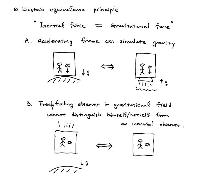

Dale said:
So it seems to me that what you want described is actually four cases, not two.
That would make sense, to clarify which pairs of cases are "equivalent", like done below:
From:
https://physics.stackexchange.com/q...the-equivalence-principle-and-inertial-frames
Likes Dale, etotheipi and PeroK
