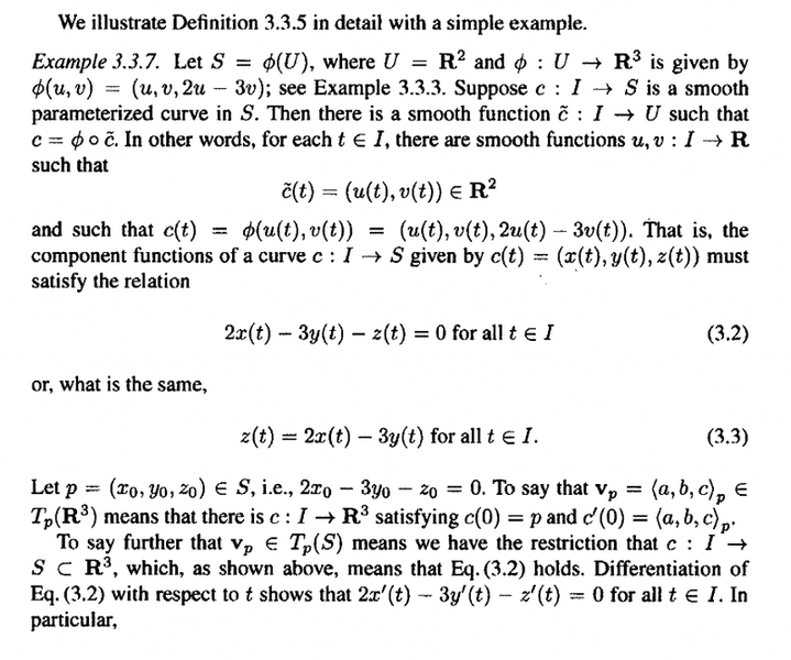

I need help with a basic aspect of Example 3.3.7 ...
Example 3.3.7 reads as follows:
Question 1
In the above text we read:
" ... ... Let [itex]p = ( x_0, y_0, z_0 ) \in S[/itex] i.e. [itex]2 x_0 - 3 y_0 - z_0 = 0[/itex]. ... ... "... BUT ... as I read the example ... ... we have that [itex]2 x_0 - 3 y_0 - z_0 = 0[/itex] is the equation of [itex]c(t)[/itex] at [itex]( x_0, y_0, z_0 )[/itex] ... AND ... again as I see it ... this is not all of [itex]S[/itex] as [itex]c[/itex] maps [itex]I[/itex] into [itex]S[/itex] ... thus a general point [itex]p = ( x_0, y_0, z_0 ) \in S[/itex] may not satisfy the equation as it may not be in the range of [itex]c[/itex] ...Can some please clarify my issue with the example... ? (I hope I have made my question clear ..)===========================================================

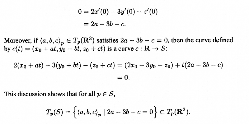

Question 2
" ... ... This discussion shows that for all [itex]p \in S[/itex],
[itex]T_p (S) = \{ (a, b, c)_p \ \ | \ \ 2a - 3b - c = 0 \} \subset T_p ( \mathbb{R}^3 ) [/itex]
... ... ... ... "Now, it seems that vectors at [itex]p = (x_0, y_0, z_0)[/itex] that have components [itex]a, b, c[/itex] respectively which obey the equation, [itex]2a - 3b - c =0[/itex] are (I think?) in [itex]S[/itex] ... ... so this would mean that [itex]T_p(S)[/itex] is a subset of [itex]S[/itex] ... Is that correct ...?Question 3

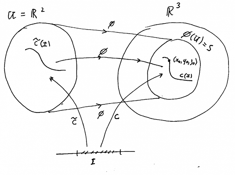

PeterI have made a simple diagram of my understanding of the mappings involved ... as follows ... ...
Is the above diagram a correct representation of the mappings involved?

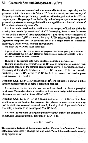

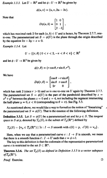

To help to give some of the context and some explanation of the theory and notation relevant to the above I am providing McInerney's introduction to Section 3.3 as follows:
