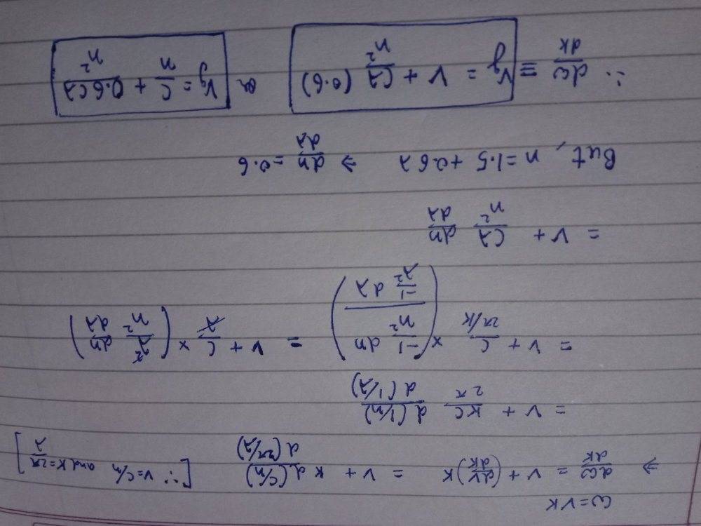

Now the value I get for group velocity is:
Vg=(c/n)+0.6*c*lamda/n^2
Is this correct?
Even so, this is not a numerical answer..

Look at your expression. It says that group velocity is equal to phase velocity plus something greater than zero. Can the group velocity be greater than the phase velocity? How did you get your answer. Please post the details of your work.
This is my work. Sorry for not typing all this out. That would have taken me hours..
The photo is upside down. Next time please post any photos right side up. It's the considerate thing to do.
Your final expression looks algebraically correct.
A quick check is to remember that group velocity is related to information transfer, hence it is always less than or equal to the speed of light in vacuum. Phase velocity, on the other hand, does not convey any information and can be greater than c.
