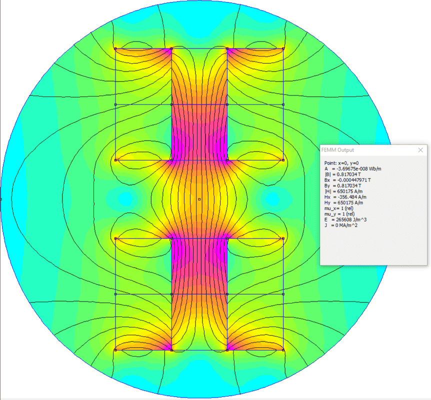

Here is a picture of the simulations:
I am not sure if I am able to upload a file as well.
For anyone wondering the simulations suggest about 0.85T in the center, while I was only able to measure about 0.35T max.
The simulation for a two 12x12x12mm Magnet seem to fit to reality very well.
If any specific information is needed I will provide that as required.
If someone has experience with simulating magnets or even Halbach arrays, your advice would be very much appreciated. Any other help is welcome as well. Thanks a lot in advance.

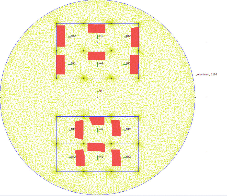

You appear to have separate 2 arrays, each of 2 x 3 = 6 cubes.
I cannot identify the orientation of the magnets.
Are they simple bipolar cubes with N and S on opposite faces?
Please give a link to the magnets you use (or similar) on the web.
A sketch of the polar orientation would help.

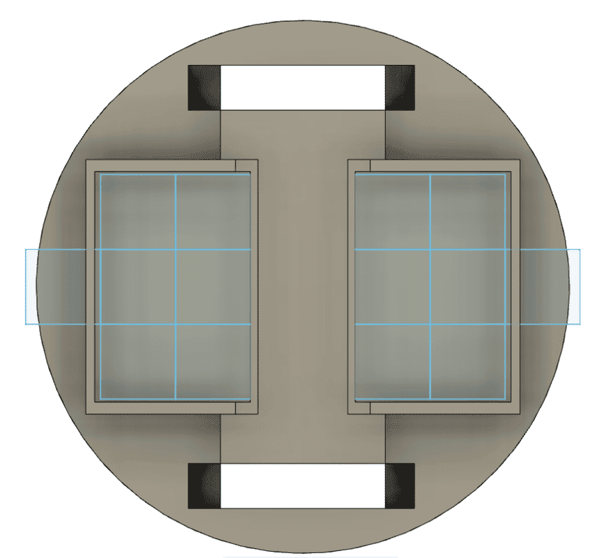

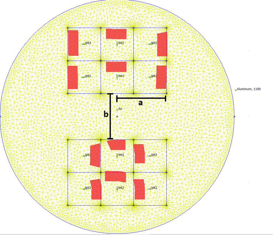

Yes there are two Halbach-Arrays with 6 magnets each, in the picture i attached you can see an arrow in each square that gives the direction of the magnetic field. The order of the Magnets should, from my understanding create a strong north pole on the bottom array and a strong south pole on the upper array, therefore a very Strong magnetic field, inbetween those two poles.
The magnets are cubic neodymium magnets and they are polarized in the direction of the arrows so they would look something like this, while red would be the north pole:
Here is the link to the magnets:
https://www.supermagnete.de/eng/cube-magnets-neodymium/cube-magnet-5mm_W-05-N
When i built the setup i had all the magnets aligned in one line, sticking to each other and marked one of their sides, similar to the picture above. Then I put them in a 3D-printed holder and glued them in place. Therefore I am fairly sure the alignment of the magnets is the same as in the simulation.

It is difficult to build two small isolated monopoles with a wide gap between them. The fields tend to remain local to the individual patches. There needs to be some magnetic circuit to connect the back of the separated N and S patches.
Also, it is difficult to build an efficient Halbach array with only 6 cubes.

A Halbach array is designed to produce a strong field of alternating -N-S-N-S- poles along one face, with a weaker field on other faces, in other directions. That is quite different to the problem here in that you want a N-pole and a S-pole some distance apart, but are not prepared to connect them magnetically. Think of a horseshoe magnet, where the strongest field is between the poles, while the curve of the shoe provides the magnetic path between the back of the poles.
The distance from the N-pole to the S-pole of a 5x5x5 mm cube is less than 5 mm, so the field will be strongest along the sides of the cube. Why would that field flow out and across an open area if there was no easy path back to close the magnetic path.
I am not sure if I understand you correctly, but do you mean that the problem is the missing connection of the weaker sides of each Array?
Because for other applications it does not seem to be required to connect two magnets at all in order two create a magnetic field in the gap between them.
Or do you mean that the distance between the arrays is bigger than the distance to the next opposing pole on the same array?
So because the distance 'b' is longer than distance 'a'?

That is true, but the presence of a field does not mean it is as strong a field as might be obtained with a different magnetic circuit. The Halbach array does not produce monopoles, it produces tight fields close to the array surface.
Correct, the field lines will remain local to the patch and do not need to cross the dividing gap.
