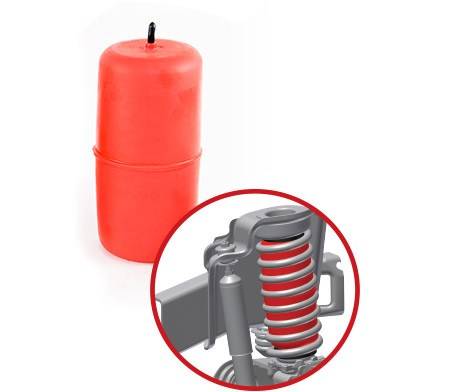

The next product is from a company called Airlift and it is an air shock ... without the shock! i.e. it's an air spring which is just an air bag that you put within the spring to achieve the same goal: creating an adjustable ride height vehicle.
The problem with the air spring is that it stiffens the ride when you increase the pressure ... unless you add weight on the vehicle. Which is why they are usually use to level a vehicle that is often loaded and unloaded. The spring I showed you in the previous post increases or decreases the ride height without altering the spring stiffness and therefore you keep the same ride quality if the weight is unchanged.
