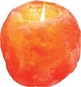

Ok i really need some help i want to make candles but i want to have himalayan pink salt dissolved in the wax I've tried but just can't get it to work... is there anyway at all that i can get the salt to dissolve? Please there's got to be away... thank you for ur time...

Well you are experiencing a chemical fact - Salt does not dissolve in wax.
The best you can do having the salt crystals dispersed within the wax.
Grind the salt to the fine-ness that you desire ie ranging from powdery to larger crystals.

It's more a matter of aesthetics. I think it's a very good idea, I have a couple pink Himalayan salt candle holders myself that give off a nice glow to a room. The problem here is that the tealight candle has to be replaced every time I light one and tealights don't usually come scented! If she can get it right, they will be very profitable candles, especially if she's using soy! If she were able to suspend the larger granules homogeneously throughout the candle, then it will give off a beautiful glow (being more transparent than regular wax), will smell nice, and last much longer than the tealights normally used in the salt candle holders. There are lots of talented candle-makers out there, I've seen all sorts of things suspended in them, and you can get them in almost any scent! This would be a very good candle in the market.
