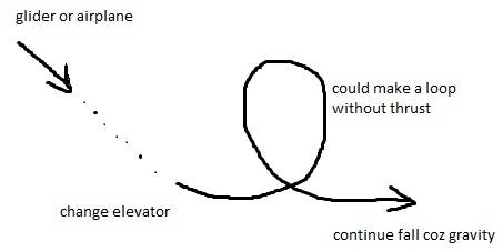

In summary: I looked for an existing equation whether it be in polar or rectangular to aid in modeling physical behavior. Hope this helpsYes flaps in case of airplane would be involved indeed, the code I put there is just one example it's not the full code but it simulate well a rock ; (dir) is the variable for the direction I could change, isn't enough for pitch angle ?
plaguebreath
I have to admit I am not good on physics but I am willing to try to understand how is possible for a plane or a glide that's falling without thrust applied downward to make a loop (by changing direction or using the elevators on the tail of plane, like in this picture.
I am try to write a program to simulate the motion of this object flying using this code (I consider only gravity for the moment not drag nor lift)

plaguebreath said:
What other force applied to the airplane that will make him loop by changing the angle of elevators ?
That would be lift -- a force at right angles to the current line of motion.
If you consider only gravity and thrust and if you are modelling a glider (thrust = 0), the motion you simulate will always be that of a thrown rock. A parabola.

Which control surfaces are changing at the beginning of the loop? I can see the loop occur if a change in the tail sections elevator moves upward and occurs at a rate that prevents the plane from stalling. Is the plane's flaps involved as well to generate the loop?

What you have is a reasonable simulation of a rock. For a plane, you need to keep track of the pitch angle as another state variable. Then you need to assign a lift which depends on the speed and angle of attack. And you need to include drag. Note that drag necessarily increases with lift. You can't gain elevation without sacrificing some speed.
A glider performing aerobatics trades Potential Energy and Kinetic Energy back and forth (with some energy lost to air resistance/drag).

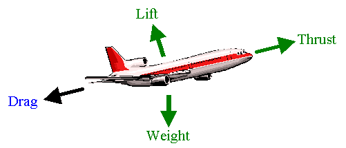

Ok, my knowledge on physics and vector algebra is quite bad so I am just learning, be patient with me.
Based on this image
let's say my airplane have a direction of 15° and accelerating, then suddenly stop acceleration and point down nose of the plane, get some velocity and still without thrusting using the aileron make plane turn up again with the nose. With the formula I write before offcurse this movement will not be done because as soon I point down my nose on the plane and stop the thruster my plane will continue to fly down even if I change my variable (dir) because offcurse that's chained with the thrust part, so how can I could make chaning x and y if not thrusting with another direction controlled by tail aileron ?
As you say, have a direction variable which models the plane's current pitch angle relative to the horizontal. You have vx and vy variables for the plane's current velocity. From these you can obtain the plane's current velocity angle relative to the horizontal. That would allow you to compute the pitch angle relative to the current velocity, aka "angle of attack".
Then you should proceed as @Khashishi has already suggested:

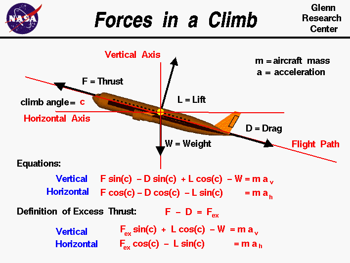

I am just getting confused, let's see what I'm doing wrong, I take this picture:
Offcurse my plane is not climbing but just free fall on axis Y (my plane have angle of 0 let's say) so my plane isn't moving backward ?
[snip]
If you have a plane that is pitched upward and is stopped dead in the air then that plane will not be airborne for long.
If you have a plane that is moving forward... Well then that plane is moving forward, not backward.

I think you can still work through this without advanced physics training. The Glenn research center slide shows some useful equations.
Here's the deal: if there is no thrust, the plane has to be pointed downward to gain horizontal momentum. Note that when pointed downward, the lift has a component that is pointed forward. It is this lift that propels the plane forward and allows it to glide. If the plane tilts up, the lift will have a component pointing backwards, so the plane is now losing horizontal momentum. If there's enough momentum to begin with, the plane can execute the loop de loop. If not, the plane loses too much momentum and starts to stall. That's because the lift depends on the forward (not necessarily horizontal) velocity squared of the plane. If you lose too much speed, you lose your lift. The instinctual action when you start dropping is to point the plane up more, but the correct action is to point it down more, so you can gain some speed and lift.
##L = \frac{1}{2} \rho v^2 S C_L##
from https://en.wikipedia.org/wiki/Lift_(force)
