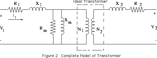

I have a center-tapped transformer and need to find its parameters such as winding reactance and leakage reactance. Which tests must be applied ? (Laboratory and equipments are available.)
It is a common center-tap transformer which is electrically demonstrated as in figure (ideal one);
246055
In my opinion, open circuit and short circuit tests cannot be applied directly. How can I place secondary reactances ? And how can I test its all parameters in laboratory ?

Yes it is E section ferrite core. But I am confused with the last thing you said; should I choose a model for primary to apply a test ? Or why I can not use common transformer model which is shown below figure ? And if I apply AC test voltages from 1kHz to 10kHz, according to different frequencies I will get different reactances values, so which one will be correct one? Don't we need to consider the saturation ? if we do, how ?
