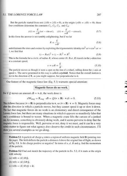

Ok, I'll post this once more, from Griffith's textbook:
There is no stipulation that you need two magnetic fields to create a force. A single magnetic field will result in a force when any charged particle passes through the field.
Force describes the change in momentum. Work is the change in momentum along the object's trajectory. The magnetic field can only change the charge's direction, but not its speed. And again, you do not need two fields, only one field.
In the case of the two current carrying wires, as I explained earlier, the work is done by the electric fields, not the magnetic fields. This is because in the frame of the charges, the magnetic fields transform to electric fields which provide a force that allows for work to be done. This is an example shown in many textbooks such as Griffiths or Grant & Phillips.

Griffiths' Introduction to Electrodynamics for one. See the discussion immediately prior to eq 6.3 (in the 3rd edittion) along with the outline of problem 6.22 from that text.
It's a little late for me varga. Besides, I want to see if experts here can rise to the challenge.
gabbagabbahey, I don't have that text. What does it say?

Why are you talking about special relativity and why change reference frame all of a sudden? Why not look at electric field from their reference frame when they exist as magnetic fields then? That is arbitrary and inconsistent, in classical physics we have absolute reference frames and they work just fine for these purposes.
We are talking about classical mechanics and classical electrodynamics, in this framework we can explain these experimental setups completely from our (observer) reference frame, just like we do for all the rest of classical physics, and so there is no reason to involve any other more abstract and complicated explanation, which I find flawed anyway.
We can measure displacement of those parallel current caring wires and it perfectly matches to the magnitude of magnetic force as given by Ampere's force law or Lorentz force equation and Biot-Savart law, so why change anything about it if it works as it is?
Two parallel wires, if electric fields of electrons cancel due to superposition with positive electric fields of protons in these wires, then we are obviously left with some other force here, and what kind of force would be the one that can act in two directions in the same time anyway - the very fact that you have two independent and different displacements suggests you have two unique force vectors at work - two forces.
As for that page, thank you. Unfortunately there are statements there that are wrong according to everything I encountered in my education, and although that was quite some time ago, still I'm talking about basics like vector math and Newton's laws of motion, so I must raise my objections. But I'm not surprised those wired conclusions were reached if the logic of it was derived from Maxwell's equations instead of from Coulomb's law, Biot-Savart law and Lorentz force equations.
- "Magnetic forces may alter the DIRECTION in which particle moves, but they can not speed it up or slow it down."
1. What "speed up" and "speed down" has to do with work done?
2. Is change of direction not displacement either with constant velocity or not?
This is the same as projectile motion or free fall under gravity field. You have to split the movement into VECTOR COMPONENTS. If bullet starts its trajectory horizontal to the ground, what does gravity do? It ALTERS THE DIRECTION. How? By causing displacement in the direction perpendicular to the motion of the bullet, yet we do not say gravity field can ONLY alter the direction, because "altering direction" is what DISPLACEMENT actually is if you look at the vertical component of the motion - vector calculus.
Take the Earth and its gravity field out of the equation and bullet moves straight as its gravity field has nothing to interact with and so we do not expect any gravity force, any change in velocity nor change in direction - Newton's 1st law of motion.
