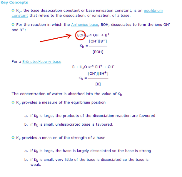

sorry for the image: It should be
The Kb for NaOH must be very high right? I found this online:
The concentration of BOH what do they mean with that? The concentration of dissolved BOH or the concentration of solid BOH? Which phase does BOH represent?

But the problem is that NaOH(aq) does not even exist! Thats not even a molecule, it doesn't represent anything, it does not represent NaOH in aqueous solution since it dissolves in ions there! The value of NaOH(aq) will always be zero since it never existed & will never exist. So the only equilibrium you could think of is the solubility equilibrium here meaning there's a solid (s) involved! And I know this is not supposed to represent the solubility equilibrium. Also all hydroxides are strong electrolytes meaning there is no equilibrium so why is there an equilibrium arrow then?

As mentioned earlier, the notition follows the Arrhenius definition
http://en.wikipedia.org/wiki/Acid–base_reaction#Arrhenius_definition
The molecule has to split up in ions for it to even to be considered as an acid or a base. Ionic bonds may define molecules just like covalents bonds may do.

Don't be so sure. pKb for NaOH is 0.2. Compare http://www.chembuddy.com/?left=FAQ
NaOH is a source of OH- and it is OH- that is the base present in the solution and ready to accept protons. Actually it is the strongest base that can exist in water (every stronger one will react with water, stripping it of protons and leaving just OH-). However, you can't introduce just OH- into the solution, you need a counterion.
