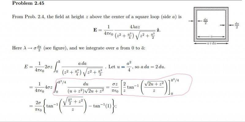

How to integrate the electric field of the square sheet

how to integrate the electric field of the square sheet( see the pink circle below)
it looks hard for me
thank you very much

Hint: Try substitution method ##2u+z^2=t##. You might still need one more substitution, but I will not comment any further before you show your own work.
Likes garylau
