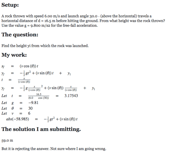

I am off by one decimal and I cannot see the error in my work

Here is a screenshot of the question I deleted on stack physics after they directed me to this forum.
Eratta:
FYI I have tried with g = -9.80 and 58.9 m when the correct solution (I think) is 5.9 rounded two significant figures. Thanks for any help!

I think you used -(-9.8) for g in the height formula. The formula for the displacement in case of uniformly accelerating motion is y=vot+a/2 t2, and a= - 9.8 now. Also, the second term on the right side should be vtan(30°).
I agree with your g assessment, but think you should reconsider that advice about the tan 30 degrees vs sin 30 degrees.
You are right, it is tangent in the formula y(x).

Your solution is wrong. for g, you have to use the positive value, g=9.8 m/s2.

Tangent = sin/cos = sin*1/cos that is just rewriting the expression. It does not change the value.
[tex]{ y }_{ f }\quad =\quad -\frac { 1 }{ 2 } g{ \frac { x }{ \left( v\cos { \left( \theta \right) } \right) } }^{ 2 }+\left( v\sin { \left( \theta \right) } \right) \frac { x }{ \left( v\cos { \left( \theta \right) } \right) } \quad +\quad { y }_{ 1 }\quad =-\frac { 1 }{ 2 } g{ \frac { x }{ \left( v\cos { \left( \theta \right) } \right) } }^{ 2 }+\frac { v }{ v } \frac { \sin { \left( \theta \right) } }{ \left( \cos { \left( \theta \right) } \right) } x+y1\quad =-\frac { 1 }{ 2 } g{ \frac { x }{ \left( v\cos { \left( \theta \right) } \right) } }^{ 2 }+\tan { \left( \theta \right) } x+y1[/tex]
http://www.wolframalpha.com/input/?i=-1/2(-9.81)*(x/(v*cos(30)))^2+v*sin(30)*x/(v*cos(30))+y1=0,+x=16.5,+v=6+solve+for+y1
http://www.wolframalpha.com/input/?i=-1/2(-9.81)*(x/(v*cos(30)))^2+sin(30)/(cos(30))*x+y1=0,+x=16.5,+v=6+solve+for+y1
http://www.wolframalpha.com/input/?i=-1/2(-9.81)*(x/(v*cos(30)))^2+tan(30)*x+y1=0,+x=16.5,+v=6+solve+for+y1

If you start with the assumption that acceleration ##a_y## is constant, you can derive the equation ##\Delta y = v_{0_y} \Delta t + \frac 12 a_y \Delta t^2##. In the case of free fall, following the usual sign conventions, you have ##a_y = -g## where the minus sign denotes the direction of the acceleration and ##g=+9.80~\rm{m/s^2}## is the magnitude of the acceleration due to gravity.
