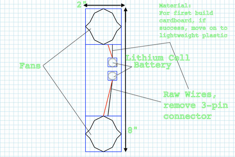

For the past week or so, me and a buddie have been trying to figure out how to make a mini-hoverboard kind of this, now it doesn't even have to look like a hoverboard we just want it to be able to get off the ground with 2 fans.
What we were going to order was all this stuff
https://docs.google.com/document/d/1AAHYts99fkmgoLAE8p_428diVQrDkwB1hzbqKf9NKAk/
Our design was to be 8x2 and up intill today we thought 2 2''*2'' fans would cover it, and we now realize they won't, and we have been looking up things for hours trying to find out how to calculate the thrust needed to lift it up, and find an estimate of the weight so we could do that, or even find fans capable of lifting themselfs up, and so far nothing, so how can I make this work?

You might consider looking at quadcopter parts.
But, there are a few other problems that you'll run into. The device will have to carry its own power source, and batteries are relatively heavy. Power sources that contain a lot of energy per unit mass, like lithium-polymer batteries, pose a serious safety hazard without special protection circuitry. A watch battery can't power a fan capable of lifting itself.
More importantly, if the board lifts off the ground, it will spin uncontrollably until it flips itself over and propels itself to the ground (probably within the first second). If you read up on quadcopters (or even regular helicopters, which have blades on two perpendicular planes to control spinning), you might find ways to handle this. I don't have the expertise to suggest anything specific.

Yes you got the 2 inch by 8 inch part right, I don't think its a good idea to try to do something of that scale (Yet), and I wasn't quite functoining so let me clear some stuff up, my main issue is that I can't find a fan capable of producing enough lift, I've looked into model airplane engines but there all almost too big and to pricey ($50 for JUST the fan, not even with the engine?) so what I'm trying to find is a small 2-5 inch fan capable of lifting itself and a few ounces of weight.

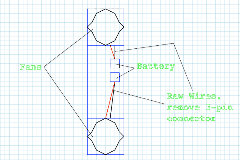

Update:
v3
I still think you are going to struggle
with the weight of the fans, board and batteries ... its going to be more significantly more than "just a few ounces"
and as soon as you find fans strong and small enough, you will have to use modelling motors and they WILL cost you serious money, to lift it all, it WILL flip over.
That is why they use 4 fans - Quad copter or even the 6 fan hex copter
its all about lift stability, with 2 fans, that isn't going to happen
My mate who is into quad copters in a big way has told me in the past, that even trying 3 fans at tips of a triangular platform isn't stable enough

Ooops. I did overlook the dimensions, getting hung up on "hoverboard" and envisioning Back to the Future sizes. Now that I'm seeing this is in model sizes I'm quite intrigued, though I suspect still it could get expensive.
There are several studies going on for extremely small flying bots that act in swarms, thus requiring some onboard computational power as well as inter-communication. Apparently some strong advances have been made in this area so that possibly soon, making a tri-fan or simply providing a higher margin of stability for 4 or 6, may be available (especially since yours might not need the radio communication at the start), though I doubt "on the cheap". That said, if it can save you on one or more fans that might be a net gain. This could get fun!

Update:
v4

Alright- so far you guys have helped alot, buuuuuut I still can't find a good fan that can lift around 2 ounces (~60g) and is under $30 each. I could calculate this myself, but I'm not quite sure how I could calculate the lift and thrust and all that, so even if you can't find any fans, can you just through the formulas out there?

A hover vehicle needs much less power than a helicopter. It is very much in 'ground effect'. I would suggest that you look into the many r/c mini-helicopters that are on sale and think about using the battery and fans from three of those. Actually, you may only need one, if you are prepared to use a 'skirt', as in a normal hovercraft. The bigger the area of the board, the more stable it should be.
If you want an idea of possible performance, it may be best to just get hold of one of those helicopters and measure the force available. You could tether it to a see-saw style balance, to make it well behaved.

Thanks for the response, I will be trying to see if I can grab a couple of helicopters in the next few days.

There is the possibility that you can buy something prebuilt and spend some time tearing it apart... and end up with a collection of parts that will work well together for less than the cost of sourcing the parts individually.
