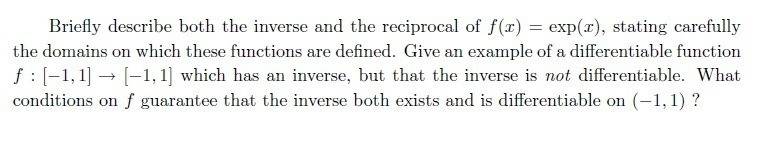

Please see attached.
I am not sure whether my example of this function is correct.
f(x) = ##sin(\frac{\pi x}{2})##
obviously, f(x) is continuous on [-1,1] and differentiable on (-1,1)
Inverse of f(x) will be ##\frac{2 sin^{-1}x}{\pi} ##
and d/dx (inverse of f(x)) will be ##\frac{2}{π \sqrt{1-x^2}}##
So not differentiable in -1,1 ??

Your problem as an image:
The inverse of the function you propose is differentiable on (-1,1). It's derivative does approach +∞ as x → -1 or +1 . ( Why does it approach ∞ at 1 & -1 ? -- What is it about f(x) that causes this?)
Can you think of a 1 to 1 function which maps [-1, 1] onto [-1, 1] but has a slope of zero somewhere on the interval (-1, 1) ?

You're overthinking this. The derivative of the inverse is 1/ the derivative of the function, so all you need is a function whose derivative is 0. In the middle, at x = 0, for example.

You need a function that is 1-1, has a derivative of 0 in the middle, which implies a point of inflection.

You can also do it with many other functions. How about a simple power?
finally, x^3 satisfy all conditions, right?
f(x)=x^3
f'(x)=3x^2
inverse of f(x) = x^(1/3)
derivative of the inverse = 1/3 * x^(-2/3) , so not differentiable at x=0

Sure, that's an easy example.
