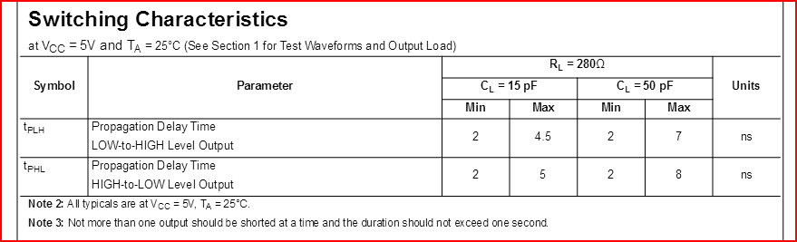

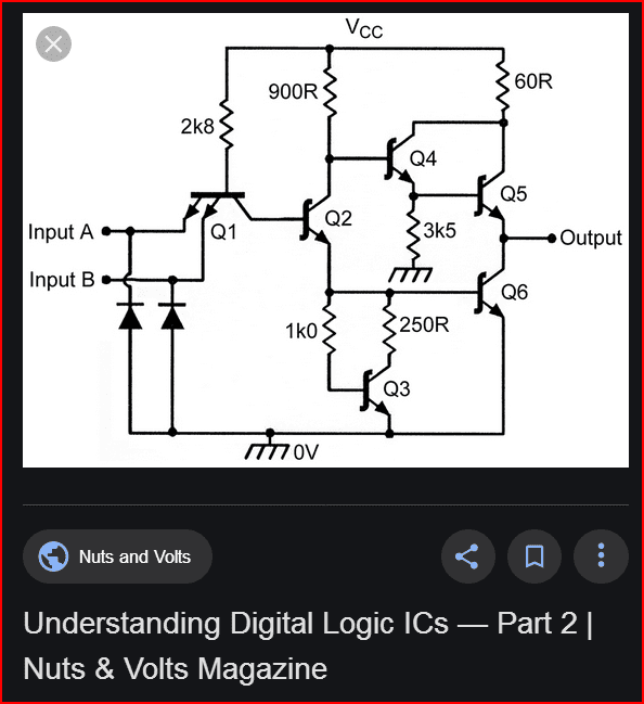

It depends on the logic family. There are assymmetries between the pullup and pulldown transistors at gate outputs and also in the propagation paths inside the gates, so in general the two propagation delays will not be equal.
You can check this by just looking at the datasheets for some typical logic gates. For CMOS gates, the P-channel FETs will be slower and weaker than the N-channel FETs if they are the same size, but the gate manufacturer may try to do some things to make them more equal (different sizes, etc.).
Have a look at a 74S00 datasheet and schematic. You can see that the pulldown transistor at the output stage will probably generate sharper pulldown edges versus the pullup transistor section, yet tPLH is a bit faster overall in the datasheet. The logic levels are also different for TTL versus CMOS gates, so that also enters into the slight differences between the tPLH and tPHL times.
http://materias.fi.uba.ar/6619/DM74S00.pdf
https://www.nutsvolts.com/magazine/article/understanding_digital_logic_ics_part_2
