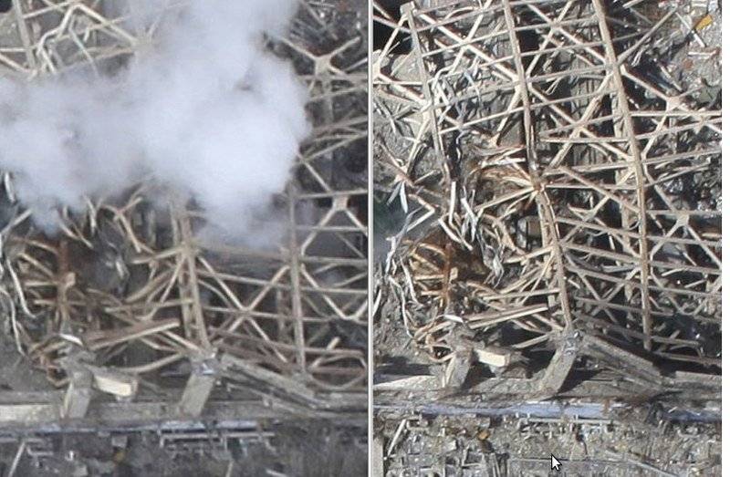

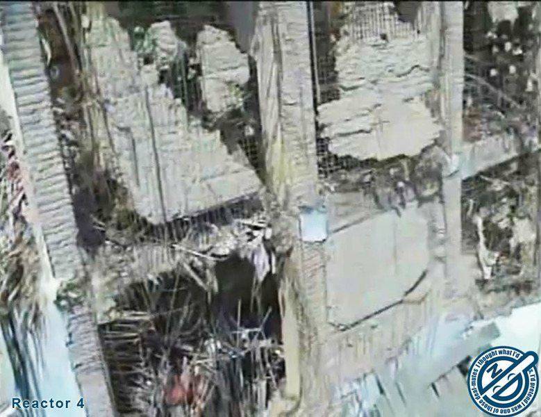

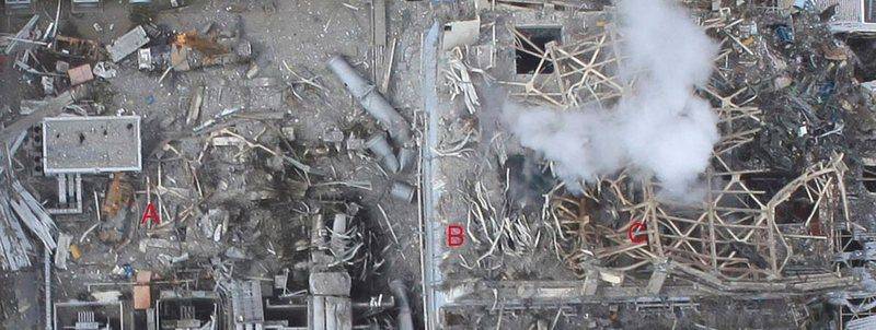

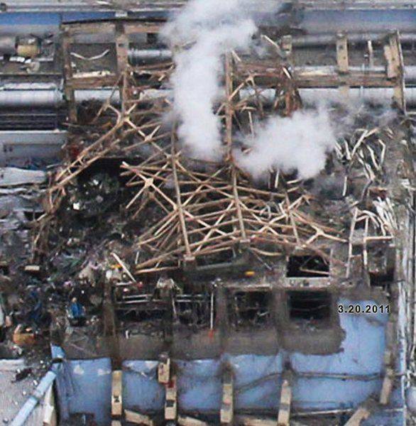

RE: MECHANISM OF DAMAGE TO BLDG 4 (AND PROBABLY BLDG 3 ALSO)
Nullpunkt has it right. A careful look at the reasonably intact roof of Bldg 1 and the girder structure of Bldg 4 shows that the roof is in "patchwork" square segments that vary slightly in their shades of gray. The same patchwork is present on the north surface of the portion of the roof that fell into Bldg 4. Looking carefully, I believe an explosion (perhaps steam?) over the SFP 4 could have neatly peeled the roof off the building like the lid off a sardine can. Once the south end of the roof was lifted sufficiently high, the north end slid into the top of the building like a giant knife. It looks like a large slab of the roof was involved. A small portion of the roof has also impacted over the southeast corner of Bldg 4 doing structural damage there as well.
And PS: There is a second green crane or some type of machine inside the service floor of the north end of Bldg 4 clearly seen through the second open panel from the right.
And that said, I think all of the damage at Bldg 3 has to be re-assessed in terms of not the FHM going ballistic (perhaps portions did, perhaps not), but instead, the entire roof itself slicing down in a similar fashion on the north end of Bldg 3 as well.

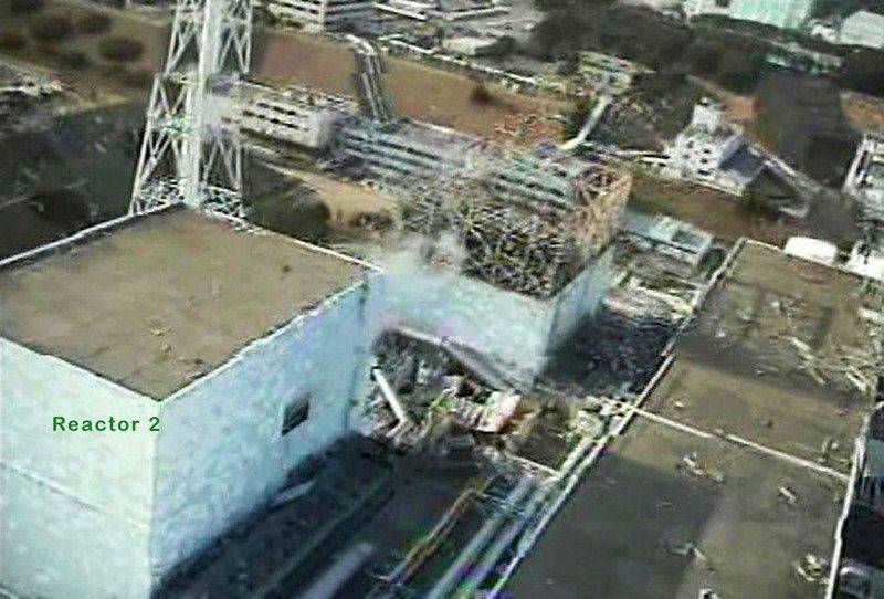

Um, there's something I just spotted about Unit 4...
Sat-Image of March 16th, Unit 4 is already destroyed but the roof is still covered:
http://www.digitalglobe.com/downloads/featured_images/japan_earthquaketsu_fukushima_daiichi2_march16_2011_dg.jpg
Sat-Image of March 17th, the cover on Unit 4s roof is gone:
http://www.digitalglobe.com/downloads/featured_images/japan_earthquaketsu_fukushima_daiichirec_march17_2011_dg.jpg

(Very OT , but if you would have seen just this picture 1 year ago without further info ,you would not have believed this could happen...I'm still amazed ...)
Odd lighting, for sure, and really poor resolution, but I believe the damage was already done. The photos are at different angles (about 45 deg vs 90 deg overhead), but I believe I can see the larger pieces of debris on the roof (small arrows), the X structure of the roof girders (rectangle), the inward bowing of the north wall, and the odd angle at the northeast corner (long arrow), even so.

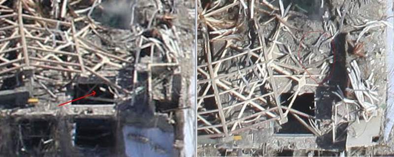

I think that the roof is already gone in this picture, but the roof's metal skeleton looks like a continuous cover because of the low elevation of the camera and low image resolution,
EDIT: ON second look, I am not so sure. It does seem that the roof tarmac is still there, but the mysterious "metal sheet" is already stuck into it.
EDIT2: On third look, it may be an illusion allright. In http://cryptome.org/eyeball/daiichi-npp/pict10.jpg" , taken with the same camera angle, the truss beams are closely spaced and cover the roof completely. With low resolution it would seem a continuous roof.

The vertical position of the fuel handling machine of unit 4 appears to me to be about right, judged from the apparent spatial relationship between the hockey stick, the overhead crane, its rails, and the concrete pillars (taking into account that the hockey stick has been distally somewhat bent, see attachment)
  • #4,115
Indeed. By the way, the "hockey stick" is not bent. Look closer.
However this seems to be the other end of the machine, which has a taller structure rising above the hockey sticks.

the lower part of the crane is (should be) about 2.5 m above the floor , it is not at present. The lower part or the crane is may be 70 cm above the floor.
I suspect the hockey stick to be slightly bent
edit: no I was using the crane from reactor 3 for reference and not the one on unit 4, I believe you are about right, the fhm crane is probably about where it should and no more than 1 m bellow where it should be
