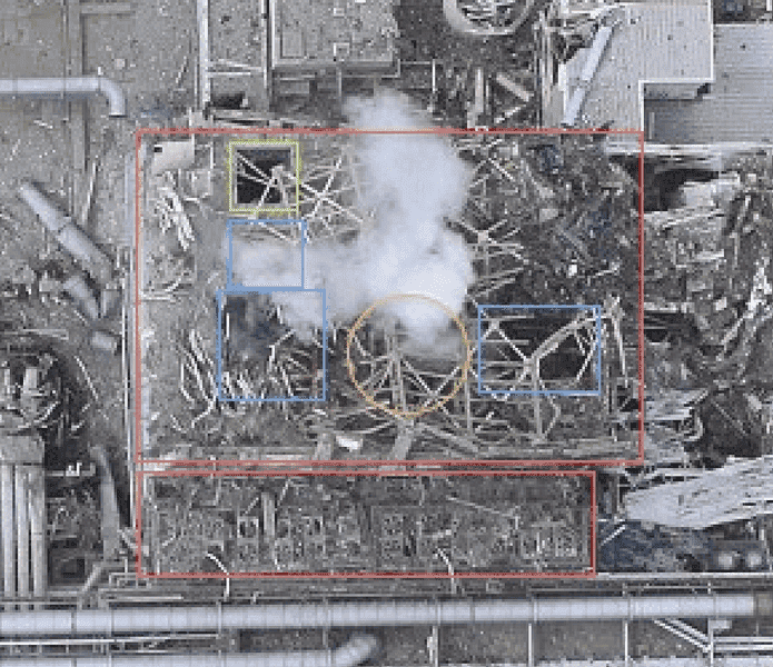

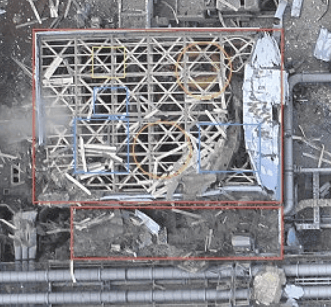

just as a reminder side by side first analysis of Unit 3 and general one
[PLAIN]http://i.min.us/imbXPu.jpg
