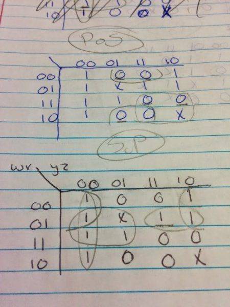

For each of the following functions with “don’t care” conditions, draw two k-maps: one for the simplified SOP and the other for the simplified POS; circle the essential prime circles, and underline the essential prime minterms (maxterms) as described in lecture. Indicate all prime implicants (implicates) and all essential implicants (implicates).
(a) F(w,x,y,z) = ∑m (0,2,4,6,7,8,12,13), d(w,x,y,z) = ∑m (5,10)
I just want to check if my answers are correct. First one seems like all 0's are essential. And the second one it seems like there are many ways to circle the 1's.
to get a more simplified answer we encircle the 1s or 0s with as many same bits(adjacent to it) as possible. So, by this I mean that the best way is to encirlce the largest circles possible. For example, if there are combinations of QUAD and BIN possible, then we essentially choose the QUAD, thereby obtaining a simplified solution.
