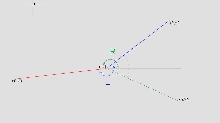

How can I efficiently determine if the angle between 2 vectors is positive or negative...
Take a look at this example drawing:
Known are the xy coordinates of 2 adjoining vectors, (I also have calcullated the 360 deg angle relative to the x-axis if that is a help ... shown with grey arrows on the drawing)
In the drawing the leading vector (Red) as adjoined to either a vector giving a positive or (left) angle, or a vector in the negative direction (right) angle.
I need to be able to calculate if the adjoining vector is a positive or negative angle in relation to the leading vector... sounds simple right? and proabably is, but I just don't seem to be able to get it right with all different vector direction possibilities
The formula should calculate all possibilites of two adjoining vectors, so e.g. could also be heading in the opposite direction where x1y1 is less than x0y0... hope you understand what i mean :)
Look forward to any help yo may be able to provide.
Many thanks, This forum has been a great help to me!

Start with the red vector, which is $\begin{bmatrix}x_1-x_0 \\ y_1-y_0\end{bmatrix}$. If you rotate it "to the left" (in other words, anticlockwise) by $90^\circ$ then it becomes $\begin{bmatrix}y_0-y_1 \\x_1-x_0\end{bmatrix}$. You want to know whether the inner product of that vector with the blue vector $\begin{bmatrix}x_2-x_1 \\ y_2-y_1\end{bmatrix}$ is positive. So the condition you need is $$x_0(y_1-y_2) + x_1(y_2-y_0) + x_2(y_0-y_1) > 0 \quad \text{for "left",}$$ $$x_0(y_1-y_2) + x_1(y_2-y_0) + x_2(y_0-y_1) < 0 \quad \text{for "right".}$$
Thanks again Oplag!
That worked fine...
Now I have found a new challenge... If you are willing,I'd appreciate you take a look at my new post.
I really appreciate your help. I'm not that great at Maths...I'm trying hard and learning, but this task is very hard for me! Without you and the help of others on this forum, I'd be totaly lost!
