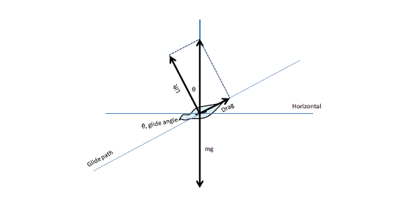

1. A bird is gliding at an angle of 15° to the horizontal at a constant velocity. If the mass of
the bird is 0.45 kg, calculate the lift and drag forces acting on the bird.
2.A bird is gliding with a constant velocity. Its forward speed is 5 m/s and its sinking speed
is 0.88 m/s. If the lift force is 29.43 N, calculate the drag force acting on the bird.
So. I have two questions I don't really know what formulas to use or anything as i havn't been in a physics type class in a while, if someone could help answer these and explain them to me a bit or just explain them it'd be great :).

Ahh, okay, well honestly, i don't think we've covered this in class. I have a free body diagram already.
Do you have any ideas on what equations i could use to solve these ? I understand F=ma, but due to them having angles it messes me up. I know Drag is 15 degrees from the horizontal and Lift is 15 degrees from the vertical.

If you can post your FBDs with all the forces and angles shown, that would help us to help you. You can post a (good quality) picture as an attachment, or scan the FBDs to PDF documents and add as attachments.
I think i attached it.
Note that lift to drag ratio is the same as glide ratio (forward speed / downwards speed) (for an aircraft or gliding bird at constant speed). I don't know if this was explained to you in class or in your textbook.

We don't give you the equations here, you really need to be able to figure out which ones to use. But I've already given you a big hint about the sum of the forces in each dimension. In your first problem, what is the component of the gravitational force in the vertical direction? In the horizontal direction? What forces counter those forces...?
