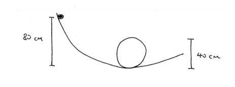

A 150 gram ball slides down a smooth track with no friction, which has a circular loop with radius 20 centimeters. The ball has an initial speed of 3 m/s. Its initial position is 80 centimeters above the lowest point of the circular loop. Calculate the normal force of the track on the ball when it is at the lowest point of the circular loop.
n-mg=m(v2/r)
I have drawn a force diagram for when the ball is at the lowest point on the circular loop with n (normal force) pointing upwards and mg downwards. I THINK the only formula I need for this problem is what I already mentioned. I'm sure I substituted in most of the values right except for the v. I made v equal to 3 m/s but I'm sure it'll be faster when it's at the bottom of the circular loop. With v=3 m/s, m=0.15 kg, r=0.2 m, and g=9.8 m/s2, I got n to be equal to 8.22 N.
Yes.
Hint: Conservetion of energy...
cnh1995 said:
Yes.
Would I use v=sqrt(2gh) in this example?
Right. Lost potential energy is converted into kinetic energy.
The initial kinetic energy as well as the gravitational potential energy should be taken into account.
Right.I didn't read the initial velocity part in the problem.
So in order to find the velocity when the ball reaches the bottom of the loop, I would use 0.5*m*(vi)2+0.5*m*(vf)2=mgh and solve for vf?
The expression would be 0.5*m*vf2-0.5*m*vi2=mgh.
So if I had to solve vf, it would be sqrt(2gh)+3 m/s?
No.
No. Rearrange the terms carefully.
ehild said:
No.
vf=sqrt(2gh+(vi)2)?
fantisism said:
vf=sqrt(2gh+(vi)2)?
Looks good!
cnh1995 said:
Looks good!
And then once I find that out, I would subtract vi from vf and use that value for v in n-mg=m(v2/r)?
Why?
fantisism said:
n-mg=m(v2/r)?
v in this formula is nothing but your vf.
cnh1995 said:
Why?
Oh alright then. I thought v in the n-mg=m(v2/r) was the change in velocity, although now that I think about it, it's unnecessary. Thank you so much!
