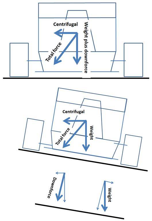

The real short answer is that we are dealing with (centrifugal force) a vehicles momentum.
Newton's first law of motion is often stated as - An object at rest stays at rest and an object in motion stays in motion with the same speed and in the same direction unless acted upon by an unbalanced force.
In this example assume no vehicle suspension, assume a flat pavement corner. The vehicle will continue traveling in a straight line. Gravity is acting on the vehicle as well pulling the vehicle straight toward the center of the earth.
Weight always acts along the global vertical gravitational vector.
Once the steering wheel is turned, the wheel direction is changed. The tires in contact with the pavement resist the straight line force. When the tire contact patch maintains enough contact the vehicle will change direction. If the tires do not have enough traction or grip the tire will slide due to loss of traction.
There are a lot of other variables involved but this is the go kart scenario and is easiest to discuss.
On a flat track, while cornering, weight and centrifugal force act on the vehicle. Technically cornering force is a component of the lateral force taken in the direction perpendicular to the wheel moving direction, i.e. considering the side-slip angle. For easier understanding we consider lateral force acting perpendicular to the tire rotation plane. Centrifugal (lateral) forces are perpendicular to the ground and have zero contribution to the vertical force ( down force) felt by the tires (other than left/right distribution).
see Race Car Suspension Class in the mechanical engineering forum of this fine website for detailed explanation.
