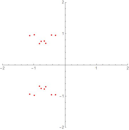

and a plot of the roots in the complex plane below. They are bounded by a circle of radius 2. The following disc size for the bounds is what I get using four calculations in the Wikipedia article dealing with root bounds found here: Bounds for polynomial roots :

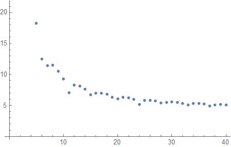

Thought I'd post my results: I ran the expression with 40 derivatives and obtained the plot below.
Updated (forgot the E term in the limit): Looks like the limsup is tending towards around 5 which is not bad. It took 1 minute at 4.5 GHz to run.

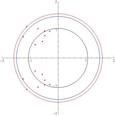

Very nice! Here's the complete code to compute (confirm) Rouche's bound of 17, then three binary searches using arg principal, and the resulting boundary circles zeroing in on the outermost zero. Note the plot of zeros is different than first plot because I am only using 6 digits of precision in the definition of the function for brevity of code.

 plot results
zRootsG =
  Graphics@{PointSize[0.0105], Red, Point@(ReIm@# & /@ theRoots)};
circle1 = Graphics@{Black, Circle[{0, 0}, r1]};
circle2 = Graphics@{Blue, Circle[{0, 0}, r2]};
circle3 = Graphics@{Red, Circle[{0, 0}, r3]};
plotA = Show[{zRootsG, circle1, circle2, circle3}, Axes -> True,
  PlotRange -> 2]
