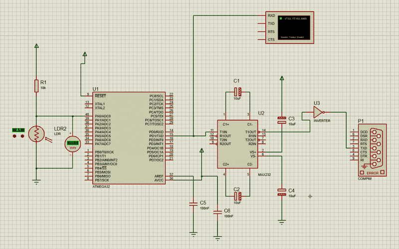

I am using proteus to simulate an atmega32. I load the code but I don't think the interrupt is firing
Code:

Circuit:
Once the interrupt fires it should send 'A' continuously to USART.
I see an infinite loop in your handler. That will cause problems.
EDIT: I see what you are trying with that while(1). It still may cause problems. Try toggling a pin instead of fiddling with the UART.

Even without the infinite while loop, still doesn't send the letter

Give us more detail...
which pin is the interrupt attached to. what have you done to debug the problem.
  • Are you waiting for an internal interrupt from the ADC?
  • You should never do any extended handling inside an interrupt routine. Just set a flag and get out. Test and reset the flag in the main program.
  • I do not follow your logic in sending a character. Your choice of shorthand indicates that you test the receiver, not the transmitter.
  • The output (T1OUT) of the MAX232 should be connected directly to the TxD pin on the connector
  • Also connect the receiver part. An open receiver input will generate all sorts of problems.
