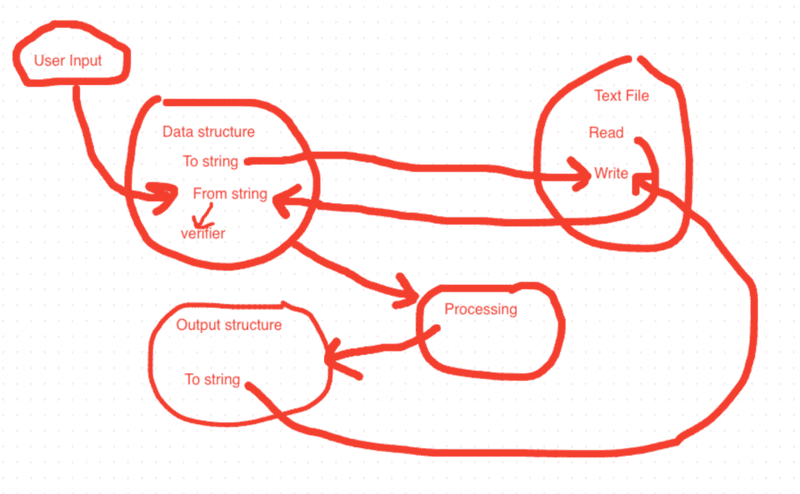

Think about the flow of your program, all of the tasks that it needs to do. The first step to writing a program is usually taking paper and pencil (actually, it's usually a whiteboard and markers) and separating the large task into several smaller, more manageable tasks. A quick whiteboard diagram of what you described:
More concretely, assuming this program is supposed to communicate with the user via plain text at a command line, I would write out a sample "dialog" between the program and the user:
Please enter the following information:
Person's ID: 12345
House ID: 67890
[etc.]
Decide on some way for the program to ask the user whether he wants to continue entering data, or stop. Show a few complete "cycles" of data entry. Then write your code such as to reproduce this dialog. A sequence of dialog that repeats, indicates the location of a loop in the program.
