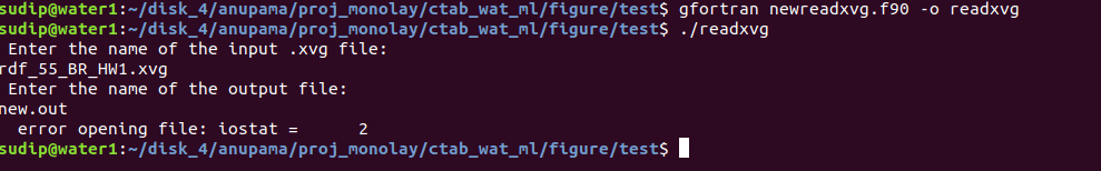

anupama sharma said:
Whenever i compile the code it shows error
What is the compiler error message, and what line does the compiler say the error is on? A screen shot of the error message would be helpful.
Here I am attaching the fortran code and also the screen shot of error message...
The screen shot you posted is **not** a compile error. It was an error that occurred at run time. I am adding code tags around the code you posted, below. I'm also making significant changes to your code to make it easier to read.
Again, I don't have a Fortran compiler, so can't verify that there aren't any small errors in this code, but it should be fairly close to what you're trying to do.
