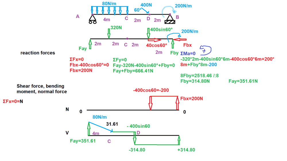

- Homework Statement
- I need to find everything I can about the beam but I dont know how to do the bending moment.
- Relevant Equations
- Σ M=0
